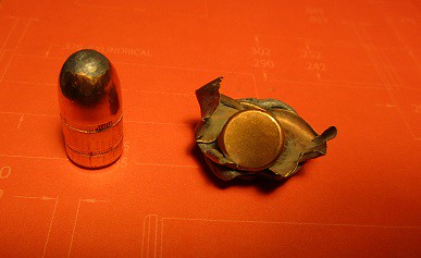

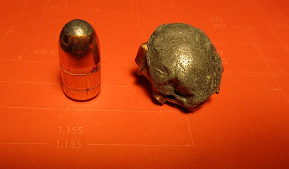

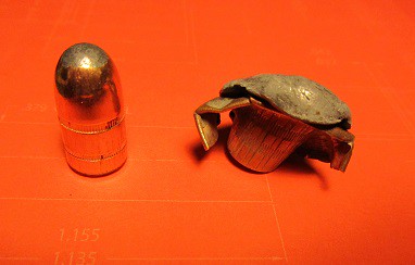

A 405gr JSP Remington (next to a 350gr RN Hornady) recovered from a Bull Moose. Raking shot, hit shoulder bone at about 1600 fps. Broke bone and lodged in the neck. Total penetration was < 18". 1 shot DRT but too thin of a jacket and insufficient penetration for my liking. Use at your own peril.
A 400gr hard cast type bullet would have shot clear through.
