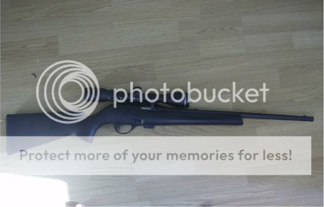

I have a 597...
I really it. Lots of threads and, lots of posts... 2 guide rails are extra cool,as long as they are finger tight.
lol
I n'er even noticed my super-model toes!
The one in the picture came pre-painted. Not too sure what paint...there are brush-strokes. I didn't/don't care... I put the screws for the sights back in so I wouldn't lose or, mix them up. Weaver base is a pretty good add-on...it is a heavy bolt and, dovetails were troublesome for me.
