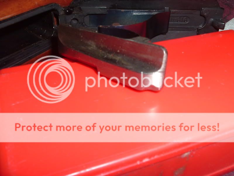

i have a .223 700P and have been having issues with the follower.
the bottom of the bolt binds on the follower, causing the follower to tip forward and stick. in order to close the bolt on an empty rifle i have to push it closed till the follower sticks, then cycle it back a quarter of an inch and then push forward again to close it. its incredibly annoying and only happens with this particular 700.
im trying to figure out the problem - whether someone modified/replaced the follower, or #%@$ed with the mag box.
here is a photo of my follower:

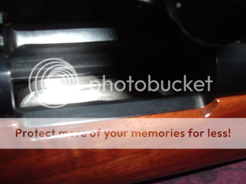

does that look right? or should it have a small lip at the top to keep the top surface of the follower down below the bolt, like this:
thanks!

bottom one isnt my rifle, the top one is. the bottom photo is actually of a model 700 .308 follower that has been modified for 6PPC, but illustrates the little 'lip' on the top of the follower that keeps it below the bolt.

basically this is what happens:
when closing the bolt on an empty mag (or when single feeding) the bolt hits the back of the follower, tipping it backward and wedging the front edge of the follower into the tiny gap between the mag box and the receiver. in order to close the bolt on an empty mag i have to push it closed till it binds like this, then pull the bolt back 1/4" and then push forward again. its incredibly annoying.
so basically i need someone to look at Pic #1 and tell me if that looks like their remington 700 .223 follower, or not. if not i can order a new one, if it does then the problem is elsewhere.
