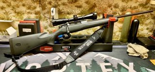

Picking up a Mauser M18 in 30-06 as my first hunting rifle (shooting for years but just now thinking about trying hunting). The rifle uses Remington 700 scope bases. I am Debating on either a Pic rail, Leupold standard base & rings or just direct mount rings.
Scope I have for it is a Vortex Diamondback HP 4-16x42 (decent enuff scope I think for hunting? Just one I have lying around from when I swapped most my other rifles to FFP scopes)
Most my other rifles are more target focused and I run 20+moa canted Pic rails. For hunting i am assuming this be mostly unnecessary and just added weight/height.
Goal is to keep this rifle light and slim. Lower mount scope would be ideal i think.

Talley Lightweights are a great choice for a hunting rifle. Regular Leupold Std rings and bases are fine. Dual Dovetails are more robust.
If it's just a hunting rifle, then those would be my choices. If its more of a target rifle I would support a Canadian company and buy a base from Alberta Tactical Rifle Supply in Calgary.
Thanks all. Opted to go for leupold standard low rings on a one piece base.
Bit to low for the vortex DB HP scope I planned but works PERFECT with an old Bushnell banner 3-9x40 I had laying around. Rifle feels good actions smooth and trigger is shockingly good. Will try find time this week to get it sighted in. Should be interesting (not a problem I may add) as I expect a good bit of recoil with how light it is. With mag in scoped up and ready to go rifle weighs in at 7.8lbs. . Trigger pull is between 1lbs 8oz and 2lbs 3oz. So I may raise the pull weight for this one a touch.
Should be a good hunting setup I would think. Much better than my other 30-06 I was going to try and use. A Axis II precision at over 16 lbs. Now to get my hunting license ect.
