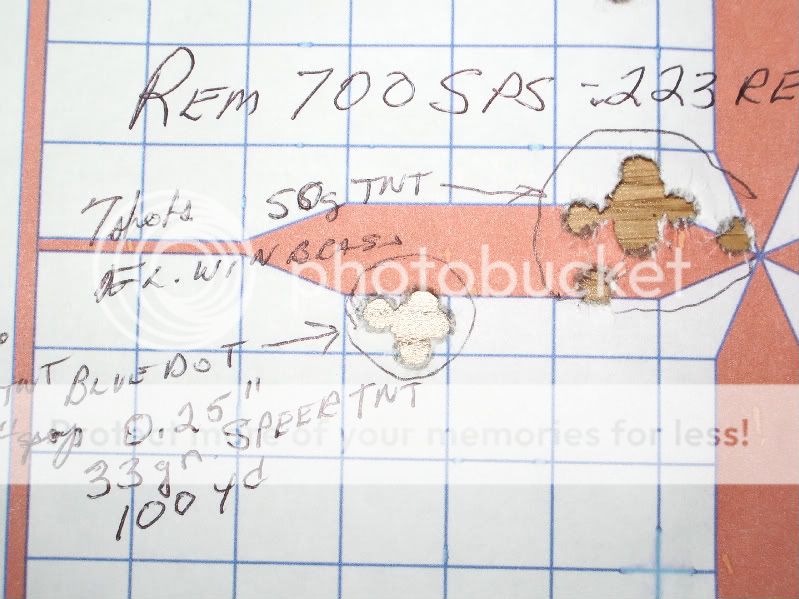

700 sps 223
This target was shot with a Rem 700 SPS, sporter, topped with a Hawke Airmax SR 6-18x44 and using range pickup brass which accounts for the fliers. I zeroed for the 50 Speer TNT at 400 meters using the SR reticle. The 33 Speer TNT Zeroed at 100 yards using the 100 yard wind-age circle on the etched glass SR reticle and was devastating at that range. Even with a bit of a cross wind I could do better than 60% on gopher silhouettes at 400 meters from the bi-pod.
I am a serious shooter, hand loader, and use this to show that the stock 700 SPS can be made to shoot. Just make sure that you have even pressure on both sides of the barrel at the pressure point located just back of the front of the forearm. Don't remove the pressure point. If the stock is severely warped it should be replaced. Make sure that the action screws are hand tight (30 to no more than 35 inch pounds).
