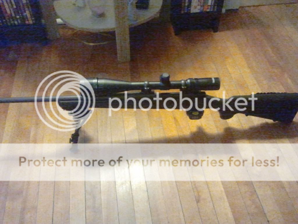

i want to upgrade the trigger on my r700 sps. from what ive seen there are several different types of r700s out there. bdl adl, who knows what else. mines an sps with a hinged floor plate for the bullets to drop out of. its a newer r700 with the x mark pro trigger but i want something thats a little lighter on the pull. so will i need to bring it to a gun smith for the trigger to get installed or can i do it myself? also can someone confirm what r700 i have so i dont order the wrong part please.
let me know if these are enough or if i need to get you guys a shot of the bottom aswell. i just dont want to guess at what it is and order the wrong part and be out a couple hundred bucks.
please dont mind the mess in the pictures, i took them a week or so back and we just bought a new place and are in the process of packing so stuff is everywhere.
also is there anything i can do to the x mark pro trigger to make it lighter? they claim it can be turned down to 1.5 pounds but who knows how accurate that is. or maybe do some at home polishing of some kind to improve on it? thanks

There is not much involved to changing a trigger. All you need is a small hammer and a small pin punch to drive the two pins out. That is it. Just make sure that you hang on to the bolt release spring so it does not bugger off on you.
To answer your original question, there is not much difference between the 700 actions. BDL, CDL, XCR, SPS...... all measure up the same. Some have jeweled bolts, better triggers and such but they are mostly the same.
I installed a jewel on my sps. Installation was simple on the receiver however i was required to do a little dremel work on the sps stock as the jewel is a little thicker then the x-mark.
