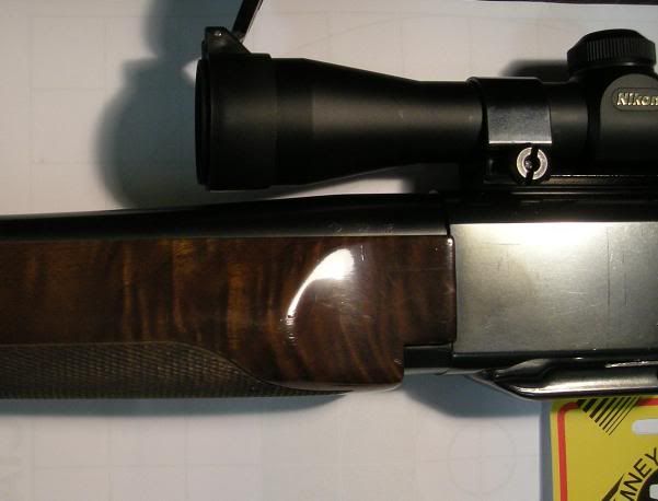

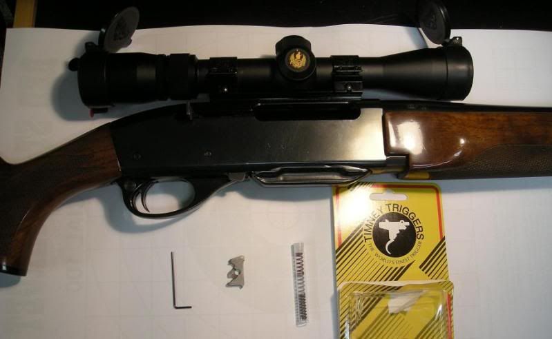

I installed the Timney Trigger Fix in my 7400 - a huge improvement over the stock trigger -

There are 3 springs provided in the trigger fix kit. I installed the lightest one but found it to be a bit too light so I changed it out to the medium pull spring.
