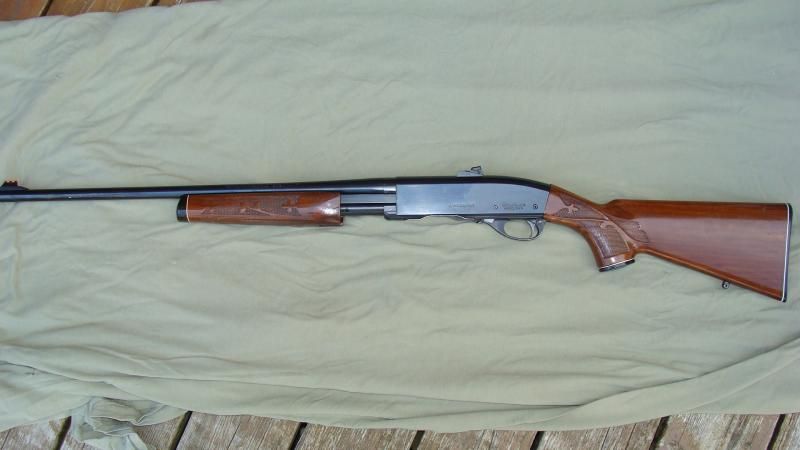

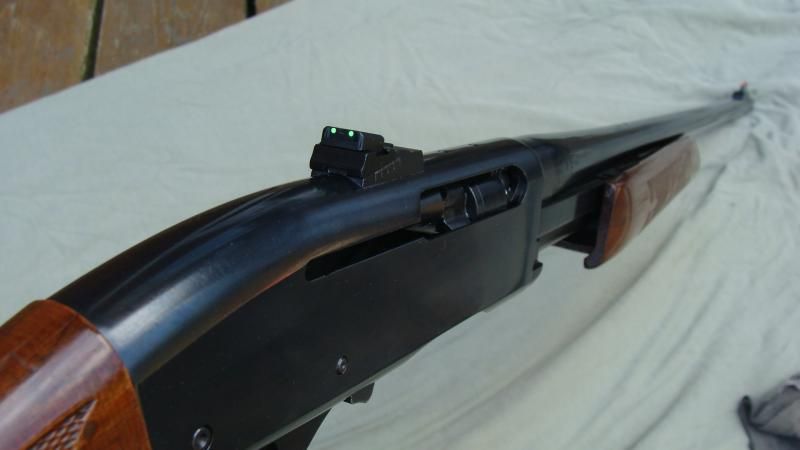

here's one that started out as a 742 semi. It's a .308 that I removed the gas block and sealed it off, I changed out the bolt head and front forend and slide. put on a set of 7600 stocks but it's basically a 760. A new set of fiber optic sites and it's a tack driver.
Hypothetically speaking if you posted that rifle for sale in the EE and I were looking at it the red flags would be raised immediately. I would be asking myself why does that pump rifle have the ejection port of a semi? Then my next thought would be I wonder WHO converted it and WHAT experience they have in that dept because honestly looking at it now makes me wonder about even pulling the trigger on it?! :confused:
you should do a little more research and you would know what the risks are for such a conversion. basically the only component that isn't designed for the pump version is the receiver , which has an extended slot in the ejection port.

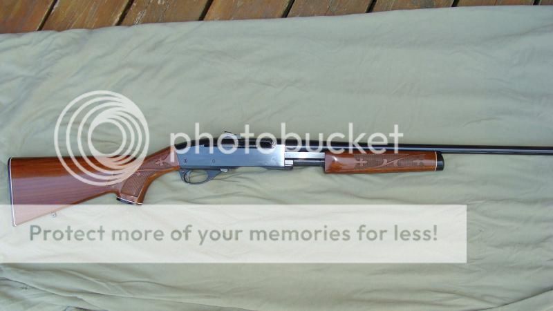

:cheers: That is kewl:)
