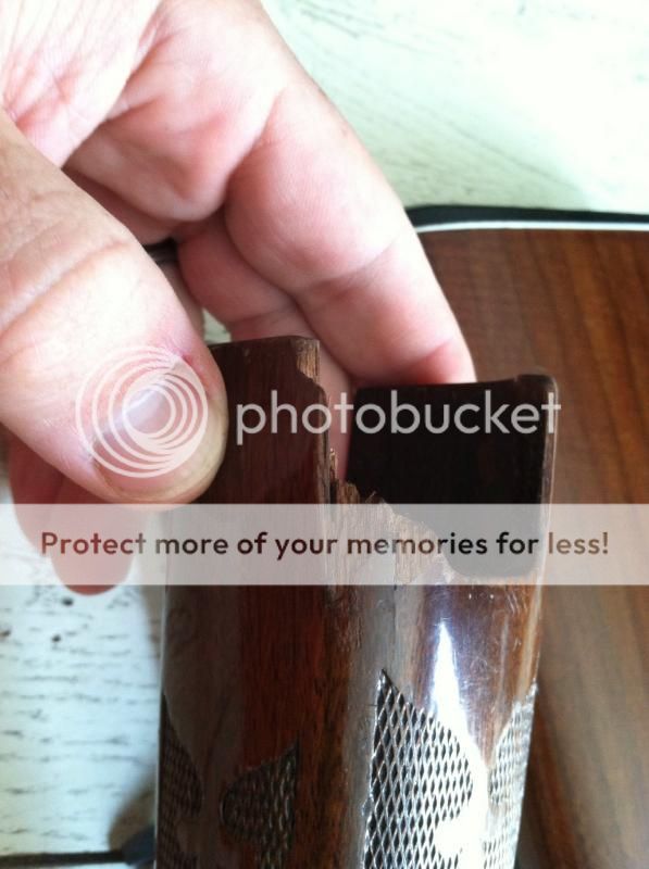

I picked up a 7600 stock set that had a damaged forend with a piece missing on the back side. I epoxied some stainless steel wire into the stock to act as ribs and filled the missing portion with some fiberglass resin and chop I then painted the glass with some paint that I tried to color match the wood as best as I could, I then spray varnished the stock to make it more durable.

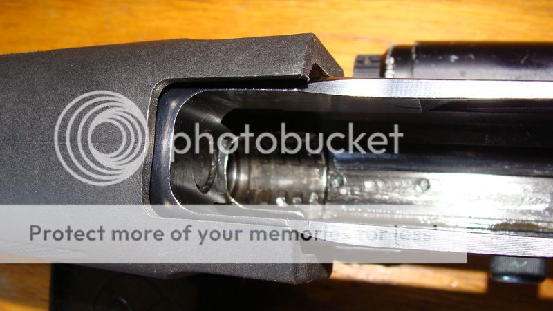

I then sweated the gas block off of the barrel and welded the hole closed, this pooched the original bluing but I wanted to make sure the mod was going to work before I invested in refinishing the barrel and once I rough fitted the parts I tested the gun to make sure all functioned satisfactory and it did, I checked the headspace and all was well. I ended up having the barrel/receiver and action slide all finished in black oxide because it was more readily accessible for me. I then mounted a set of fiber optic sights I had laying around, I mounted the rear sight a little farther back on the receiver and I will see how that works but right now I looks like it might work fine. The only piece I still require is the plastic dust cover over the bolt. It looks a little weird with the slot in the receiver but I like the fact I'll get a little more life out of the old girl.

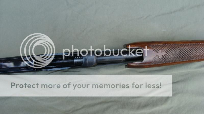

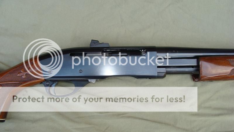

Here are a few pics of the setup.
here's the broken forend before the repair

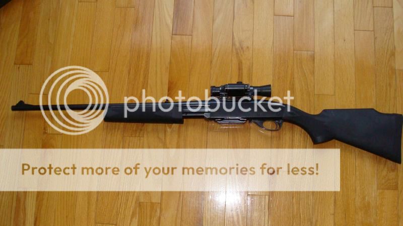

I did another conversion should call these 7642's
This one is .270 cal. It's wearing synthetic stocks and a red dot sight.
