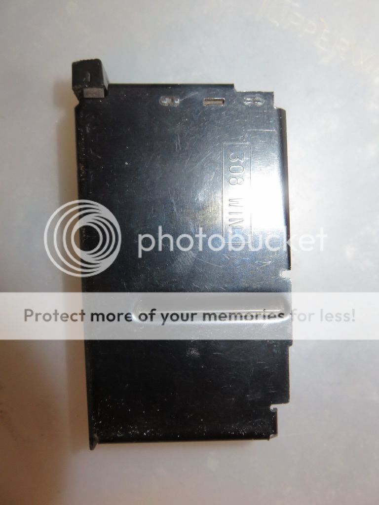

Single position feed, the catch is part of the magazine. Little black plastic thumb piece. If the plastic is broken off, sharp little prongs of steel will be exposed.
I have to agree with tiriaq on price, the asking price for these nice rifles is crazy. One on the EE now for 650, and I see prices like that at gun shows as well. Way over priced for what they are and don't lose the mag as they are getting scarce. I have one in 222 with a canjar trigger that is very accurate but if the right replacement comes along it's gone. I feel 300-350 is a fair price, and all i'm willing to pay for a discontinued model with parts drying up.

PS your mag is for a 788
