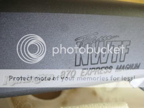

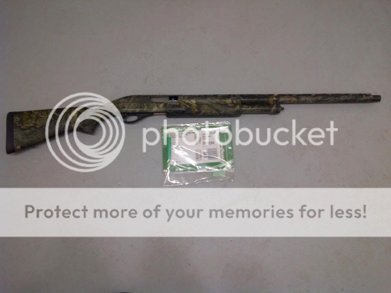

Here is mine Rembolt she handles 3 1/2 no problems. I am wonfering if the one he is talking about has the side stamped like this nwtf or just express magnum. Some of those early ones were 3" and someone could have put a 3 1/2" barrel on it. Have to remember if a barrel was ordered as a replacement from remington regardless if you order a 2 3/4" you wilkl get one that handles 3 1/2" I just went through this with remington on a replacement wingmaster barrel.Makes sense for them to stock one barrel to cover all.
