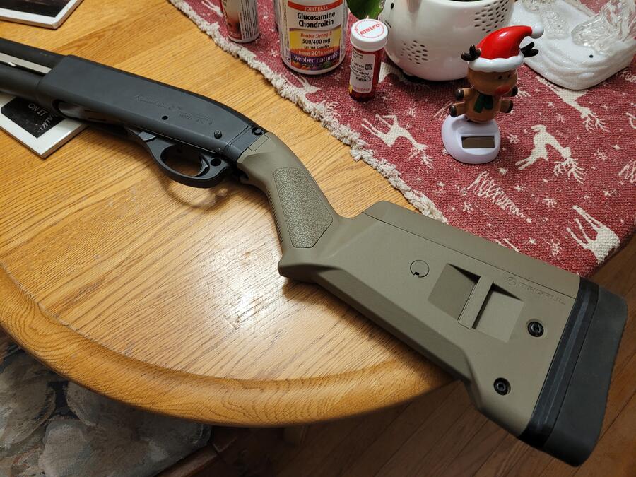

Wexwill have a series of what we are calling the next generation of MCS parts
Like this Magpul unit as well as for mossberg 590
How much does it add to the length of pull, and distance to the trigger? Did Remington commission a special pistol grip from pachmayr for that old program?
It's just over 1/2 an inch.
Remington uses there Smith and Wesson 44 magnum grip. I have 2 of them the pistol grip metal adaptor is quite quite complex. So still working on that design
Does this require a unique receiver, or will it mate a normal 870 to a Magpul and give it a QD function?
The adaptor plate will work with any Remington 870 receiver. It will require the receiver stock nut to be made shorter and a new shorter one installed (we will be making new shorter nuts.
The stock side will require alot more work to install thr steel quick release.
This is why we will be selling the modified stocks as a complet unit. Ready to go.
There will be several options.
