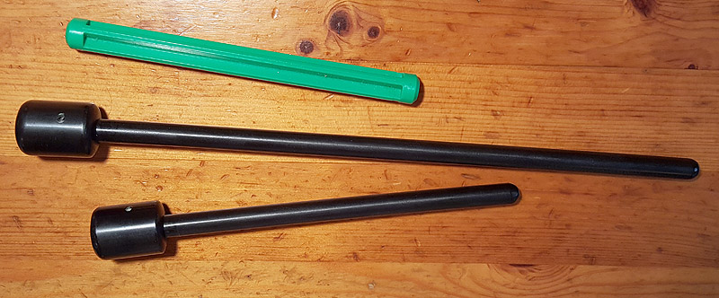

Here a picture of the result.
Plugs for my + 2 extension setup and for my +1 extension one … (the green one is the original Remington plug).
I realized that Delrin as a material is super tough …. but is still easy to work with … drilling, grinding, sanding, polishing …. all worked well with the material.
Voila, these plugs should last a lifetime ….
