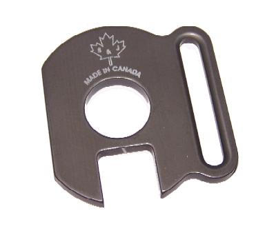

I've looked at the sling adapters that S&J Hardware carries and from what I have gathered is that they are for one point slings.
I guess I should also note that I have a full stock, if that's what it is called, and would like to keep that set up if possible. So if you have any ideas of adapters that fit onto a full shotgun stock it would be greatly appreciated.

Just finished a Fighting Shotgun course. Most people had a single point sling - those with Rem 870's had a S&J Hardware sling mount.
I had a Fabarm and had a S&J Slingmount as well as the front sling mount with a 2 pt Vicker's Sling... that worked pretty well. I also have a Blueforce Anaconda single pt sling on my Rem 870 with the S&J sling mount.
I suppose if you wanted a two point on a Rem 870 you could get a sling mount that would go on the front of the mag tube and then the S&J unit... Don't know which one I prefer... if I had to pick I'd go for the two point sling. Easier to get off if required...

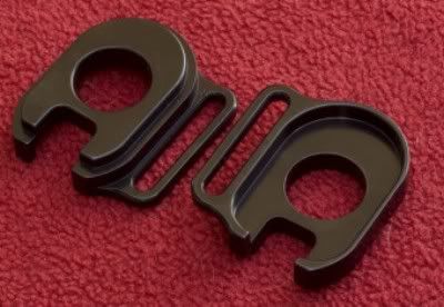

If you looking for an all around set up , i would say one of our S&J single point sling mounts and a wilson front side sling mount we sell both retail price is $45 and $15 but free shipping for CGN members.

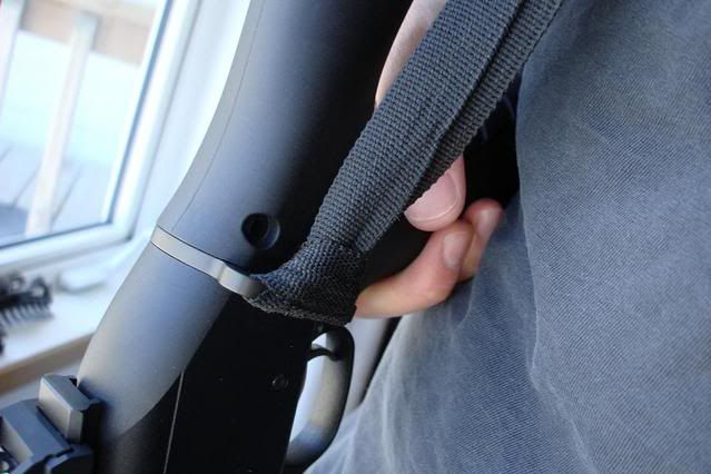

some pics and a video for you

As for attachmetn points you could use the standard sling studs or if you want to go more complicated use the styles (GG&G. Dlask, Wilson Combat, sjhardware etc) that mount between the rear of the receiver and the stock (burnsed loops) and also the front sling mounts that sit behind the mag cap...this will allow the gun to sit flatter to you with one side against your back (did that make sense?)

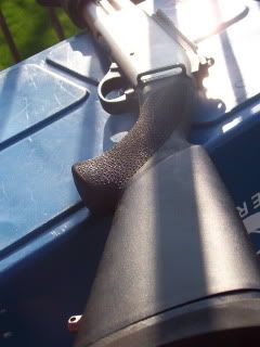

Okay, so I have decided to go with a two-point sling, the only problem is that my 870 synthetic stock does not have a stock stud. Any ideas? Or do I just have to buy a new stock with a stud?
