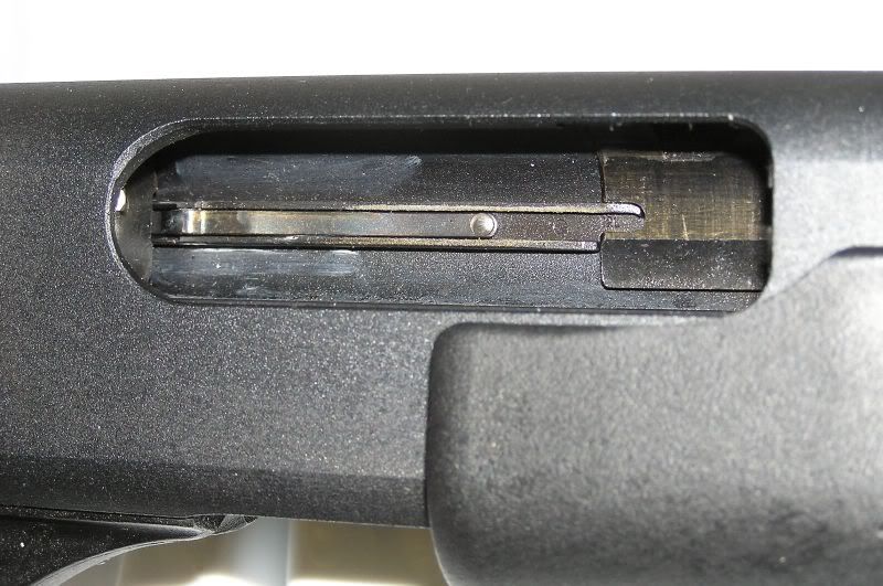

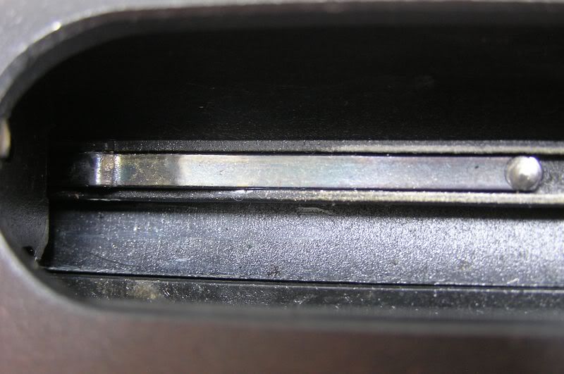

The ejector spring looks f**ked compared to my winchester, it's so flat no spring to it at all no wonder it's not ejecting the shells? What's up with this?
Below is some pics of my winchester (black) and the remington, let me just say I am not impressed have heard of some problems with the 870's but never knew it would be this bad, if it's a simple fix then it will be alright don't really want to send it back to remington unless I have to, my winchester cycles like butter and ejects shells like 5 feet away and I was hoping that the 870 would be some what comparable.

Winchester spring, nice and springy :)
Remington Spring :(
I am pretty sure the hard extraction is due to machining burrs on the barrel extension just back of the recess for the rim of the cartridge. I have observed (and fixed) this on dozens of newer 870's; particularly the express models. The ejector spring really is not a serious problem. It can only pop up as far as the bolt will allow. From the photos I think it is probably working as it should.

I don't really understand what you mean in the first part of your response??? Well there is absolutely no spring at all in the ejector spring it's pretty much flat with just a bend in the spring there really is no spring action at all compared to my winchester, if this is normal that is cool, is there something I can do to fix this on my own?
The spring is normally like that on 870's.

I forgot to add las time... the extractor in mine doesn't look much different than the one in yours, it may just be bent a little bit more inwards, but not much. Here's a couple of pics:
Mine is a relatively older model, about 7 years old. I haven't tried the alluminum base shells, but it has never jammed with brass base shells. I checked the chamber and it feels pretty smooth to me, so I guess I lucked out. :dancingbanana: However, mine did come with the STUPID dimples on the mag tube, so I had to drill them out in order for the mag extension to work.
