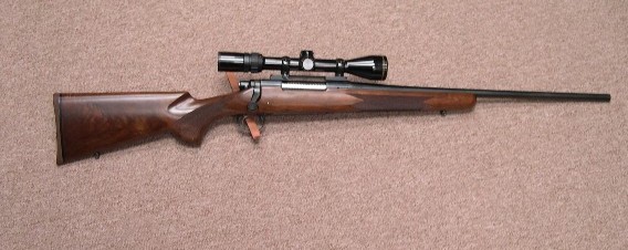

Very Nice NAA ! Great caliber ! Here are a couple of pic's of mine!:)
Badbrass - Nice sweet rifle! You will be happy with that one for sure... I'd like to get one in 7x57mm & am still kicking myself for not jumping on one the year they came out in 7mm-08....... After seeing yours, I'm reliving my folly! :(
Congratulations on your "Classic" It's no secret that I love this 700 variant, and I have rifles so issued in 6.5x55, 7mm Mag, 300 Savage, and 8x57. I also have classic stocks on a couple of custom 700's, because I like the design so well. The 7-08 is an excellent performer, essentially putting 7x57 ballistics in a short-action package. Usually are quite accurate as well. I have a 700 Mountain rifle in 7x57, and it will shoot the first three into well under an inch. [do try the 140 Accubond!!]
While I like and use H4350, H4831 and Varget, I'm not overly worried about Temperature sensitivity. [whatever did we reloaders do before this became an issue? ;) :D ] (no offense intended, Richard) In my 7x57, RL22 is the ticket, giving very good velocity and sterling accuracy. The slighly smaller capacity of the 7-08 may make RL 19 or the 4350's a better choice, as some have noted. RL 15 will certainly work OK with light bullets. In any case, Enjoy your new shooting iron, it should be a winner! Regards, Eagleye.
