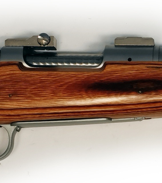

I'm using a Leipold standard 2 piece base, but it looks like the rear mount blocks the loading gate/ejection port.
It's the corrwct part number , installed in the correct direction, screws closest to muzzle.
Is this going to cause problems ?
The rear base in the top picture is for a Remington 700.
It is a Burris mount I found after removing it today.
How can you get the windage screws in the correct position without alignment bars ?

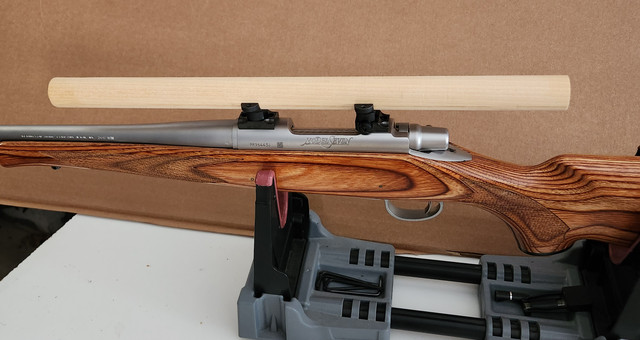

Insert the windage screws, count how many turns until they bottom out. Use thsoe numbers to center them, and check your alignment. - dan
Go buy yourself a 1" wooden dowel.
Or look around yer casa for a broom handle.
Sticker in the front ring.
Make sure the front ring is in there where it needs to be.
Put your rear ring in the base and go 1/4-1/2 turn on the rear base windage screws until
the ketchup to the ring.
Go slow and wartch wutt yer dewn.
Throw that Fugly #### away and install a set if talley 1pc LW rings ! Those bases are klunky and heavy and wrong . RJ
I did tjrlw them out, turns out the part number on the is for a 700 not a 7
I've like these windage adjustable bases and and have the right ones now...my friend had alignment bars I used.....but I moved...so no more access.
My wife has some in her pile stuff.
Worked great, thanks for the tip
