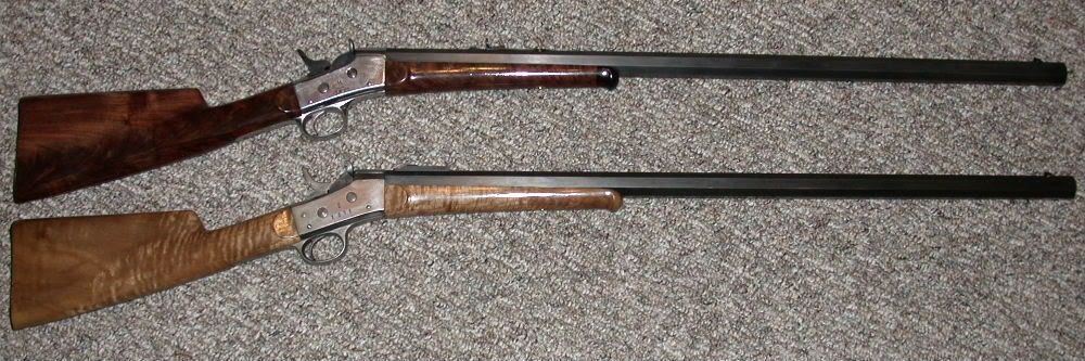

I have been looking at the Swedish Remington Rolling Block rifles that can be obtained for a decent price in the Tradex site.
Have not yet researched the action much but the wiki page gives a bit of history and it would seem like a strong enough action to adapt a modern cartridge to. I was thinking something small for the gopher patch, perhaps 22 K-Hornet or 17 Hornet. In this case it would no longer be considered an antique but with the demise of the LGR it will not be much hassle.
The other thought was to use the action to make a Olde Tyme buffalo style rifle, in perhaps Sharps 50-90. By the time I get a .50 barrel and all the work done I could likely buy a repro Sharps, but its the project that gives me as much (if not more) pleasure than shooting the final project.

I have built 3 .. two were 50-90 sharps done on Antique Swede`s and the other was a 38-55 done on an Egyptian. Currently working on gathering the parts and pieces for 2 more to be built on the 8x58 swedes from tradex. One will be a 40-70 sharps straight the other one a 38-55. Unless you are a capable smith \ machinist your expenses will indeed surpass what it would cost to buy a new Pedrosoli. Lots of fun to tinker with and a decent challenge even if you have experience. You certainly wind up with something unique but likely never get the money out of the build.
