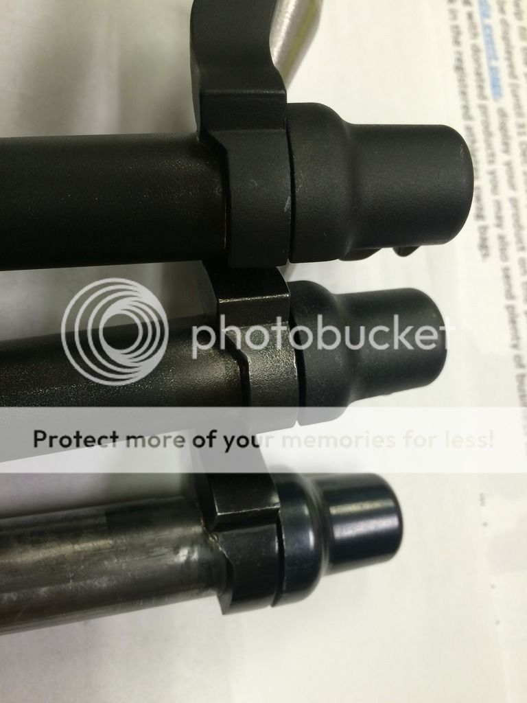

The problem is more than a bad joint, it is compounded by the lack of a proper primary extraction ramp on newer Remington bolts.
I recently bought a SPS that would not extract factory ammunition without hammering the bolt back ( I have neither fear nor good judgement)
A comparison to my 30 year old A-serial numbered 700 bolt showed the change, and I had the handle removed, the ramp rebuilt and TIG'd back on and things are all good again.
If you look at the photo, top bolt is a unfired current production SPS, middle is the bolt that has been re-done correctly, and bottom is a 70's vintage 700 bolt. I would not re-attach a factory bolt without fixing the ramp.
