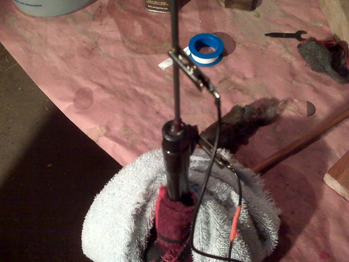

You need a metal rod about 1/8" in diameter and 6" longer than the barrel length. Take a fired cartridge, wrap teflon tape around it and close the bolt on it - that seals the bottom. Wrap electrical tape around the bottom of the wire rod to isolate it from the fired cartridge and do the same to the top right where it exist the muzzle. You want the rod to be one electrode and the barrel to be the other. They need to be isolated from each other. I secure the gun in an upright position and use pure Household Ammonia for the electrolyte and fill the bore to about 3" form the top. An old battery charger with a 6 volt setting serves as my electrical source. Attach the negative lead to the barrel and positive to the rod, turn on the power source and away you go. It will foam up (which is why you don't fill the bore) and after about 20 minutes I turn it off. There will be a deposit of black gunk in the rod. Run a few patches through and you're done. I don't know how much is the ammonia and how much is the device, but it works well. Just not worth the effort IMO.

i built the electric gun cleaner today and im amazed at how well it works
tested it first on enfield no1, there were actually chunks of crap come out, and the ammonia turned a bright blue. i've got a k98 bubbling away right now
total cost was 15$, i got a 2 d cell battery box and some alligator clips from radio shack, and a steel rod from canadian tire, used wires from an old power box from my router and 5 mins connect the wires and i was in business

cut the power box and connector end off the old power plug so you have the 2 strand wire, split the wires apart at the ends
connect the wires to the battery box pos and neg ends, with some solder and then the shrink tube
connect the alligator clips with solder, i used a piece of tape on the positive clip so its easy to see
give the steel rod a couple rubs with some sand paper to give it a bit of shine,the cut a couple of piece of larger heat shrink tube and shrink them to the 1/8 steel rod, i left mine loose enough that i can move them around on the rod. this will keep the rod from contacting the barrel and stopping the flow of electricity in the barrel.
i used the Teflon tape over an empty casing to seal the breach
fill the barrel with ammonia and let it sit for 20 seconds, then dump that out so all the oil is gone
refill and place steel rod in the barrel, making sure that the rod doesn't contact the muzzle directly
Place the negative clip on the steel rod, and positive on the gun barrel (front sight, rear sight, what ever) with in seconds the ammonia will start to bubble up so you know its working
want 20-40 minutes and dump it out, run a couple patches through the gun and a bit of oil and admire that your guns have rifling again. you'll be amazed at the crap that comes out of old milsurp rifles
my enfield came out electric blue with copper flakes, my k98 was lead fouled and it came out dark with chunks of stuff. the rod will be covered in black crud too
Word of warning about the ammonia...it will peel a varnish off wood faster than a good wood stripper, so you will want to wrap the barrel with a towel to catch any spillage, its ok on blueing though.
