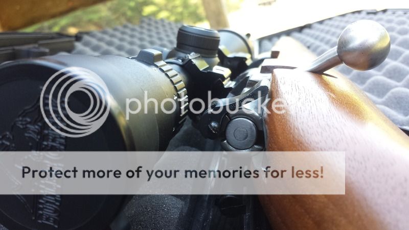

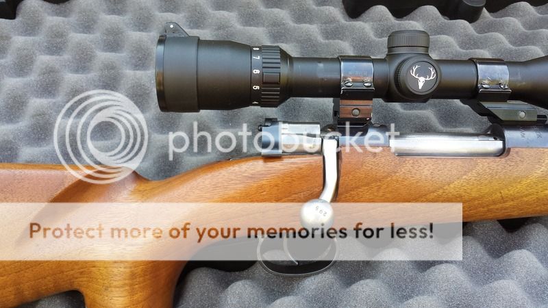

This is a custom I have made for my Swedish Mauser. It is based on DAYTON TRAISTER - MARK II SAFETY from Brownells:
http://www.brownells.com/rifle-part...3-m-94-m-95-m-96-sku240001950-5686-13480.aspx
It requires making a cut in the shroud; not too difficult.
