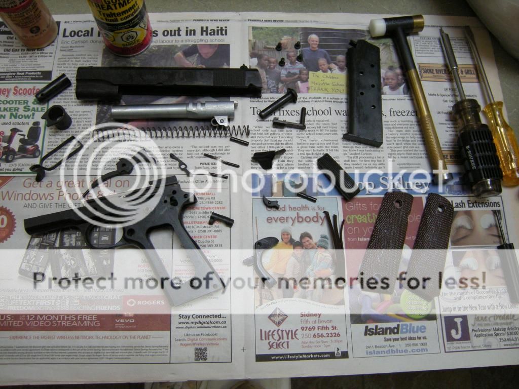

Detail stripped, cleaned off all the gunk [make sure you have 2 or 3 good shop rags on hand]. On reassembly put a light oil on all parts that move or rub together.
