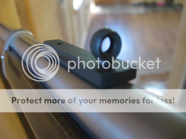

Either a Lyman or Williams could go on the side of the receiver like this,
Or you could get an XS that's made for Winchester 94's ( may be discontinued) and mount it like this,

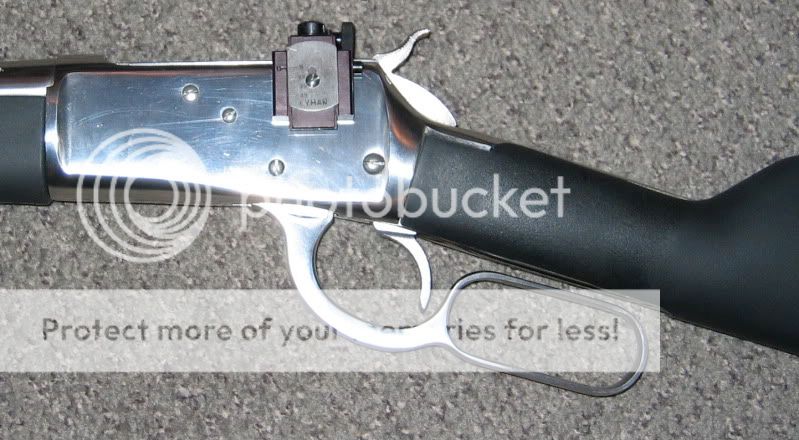

Some of the 92 clones have a safety lever in the bolt and if yours is one of them you can replace that lever with a sight that Steve Young makes that looks like this.... It is only adjustable for height so windage must be corrected with the front sight.
Steve Young is very friendly and knowledgeable about these 92 clones...
