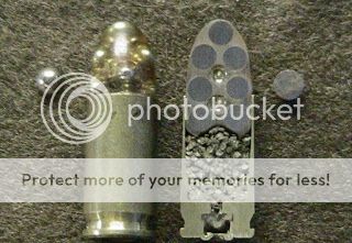

Couple month ago I ran into quite interesting bullet on AR15 website. Bullets cross-section.
Here is the description:
"9x19 "Sky Marshal"
9x19mm Israeli "Sky marshal" TZ - 1 -72. Brass cased, projectile is stainless steel balls in a resin matrix.
Developed as either a squeeze bore, were the round is broken up in the barrel of the pistol for a shot gun effect, or as a frangible that would break up on hard targets, but enter soft ones. It was rejected and eventually given the name "Sky Marshall" by a D. Dietz. Same time frame as the Israeli SSB (Salvo Squeeze Bore?) loads made by Colt. Not very accurate."

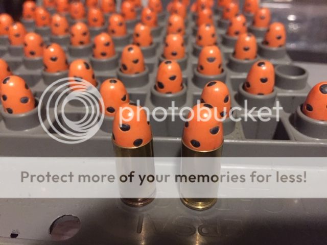

Up to a challenge. Whole idea of shooting steel balls in hard epoxy looks quite dangerous and barrel ruining idea. Decided to try lead pellets in plastic. Since I have injection molding machine it was easier to make mold, fill with bird shot and inject plastic. Coming out as 52 grain projectile.
Just loaded 50 of them, going to try next weekend.

Just a quick update. Finally had a chance to go shoot them. Average speed is 1350 fps. Those are shotshell rounds. Opening up when leaving barrel. I have 9 of #3 pellets in each right now, bullet is regular 115 grain form factor. Would be a surgeon nightmare at close shot. Half of them were stove pipe, need to adjust powder or bullet weight. Going to machine mold to 147 grain size. Should solve issues with cycling. With CCI shotshell 9 mm round at $1.2 US those are quite cheap to make.

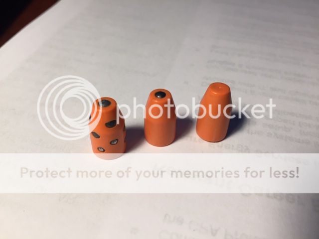

Here are the new ones. One of the left has 13 pellets, 72.5 total bullet weight. Cycles perfectly.
Middle one has just one pellet at nose, 16.5 grain, doesn't cycle, but lots of fun to shoot as single shot. No recoil.
Right one is just the plastic, 13 grain weight. I shoot those with just primer. Around 300FPS and quiet. No deformation, I reload them up to 10 times.
