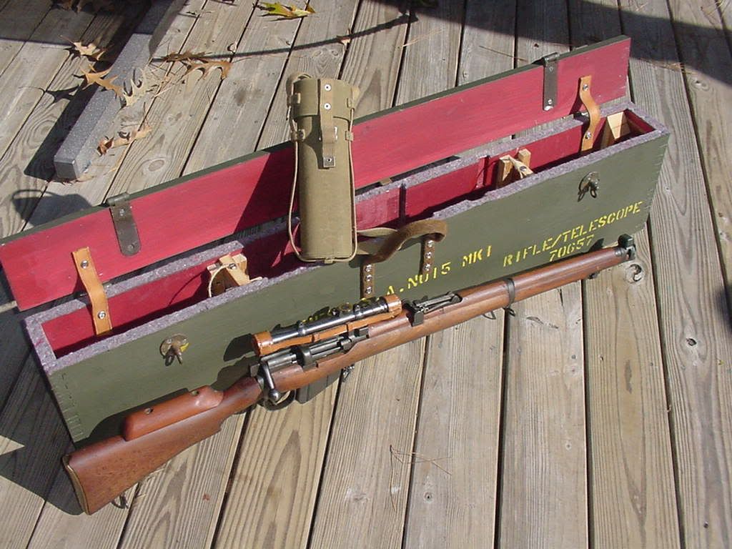

No 1 MkIII H.T. Sniper transit chest (repo)
Greetings All,
I was lucky enough to find a good wood worker and someone who knows Enfields to build me a transit chest for my Australian low mount sniper. Since one was never issued, it afforded me the opportunity to mark it as I saw fit and what I thought would have been appropriate nomenclature. If interested, you can contact Chris at Cataldob@msn.com in Indiana(?) in the US and take to him about building one for you.

Here's the No 7 case compared to the #4T case. Both have the original writing on the sides and matching rifles. I have seen No4T cases with yellow, grey, pale red and pale green or as in this case, exterior olive interior. I have 4 No7 cases and they are all olive interiors.
I have seen multi gun (4+) boxes but they are made up for rifle teams, usually out of some type of large crate and painted by the unit, to protect the rifles once ready for match use.
This one is complete with all the cleaning tools, one piece rod (obtained from this site) and original tragets. Forgot to put a box of ammo in. You can just see the cleaning tools on the left of the bracket standing up on end. The box is slightly smaller than the No4T box.
Note the leather straps vs canvas and the latch's are bare compared to the protected latches of the No7. A local gun dealer told me they used to smash up the crates and throw them out in the 60's and 70's, along with the scopes as the rifles were "sporterized" for hunting. "Too heavy to cart up and down the stairs". The new Springfield Garand's came with a nice rifle box, kind of similar to these but they opened from side to side with the top falling backwards and the gun was left sitting on it's two wooden pedastles.
For ####s and giggles I put in the two different scope cases and the rest of the stuff found in the case.
