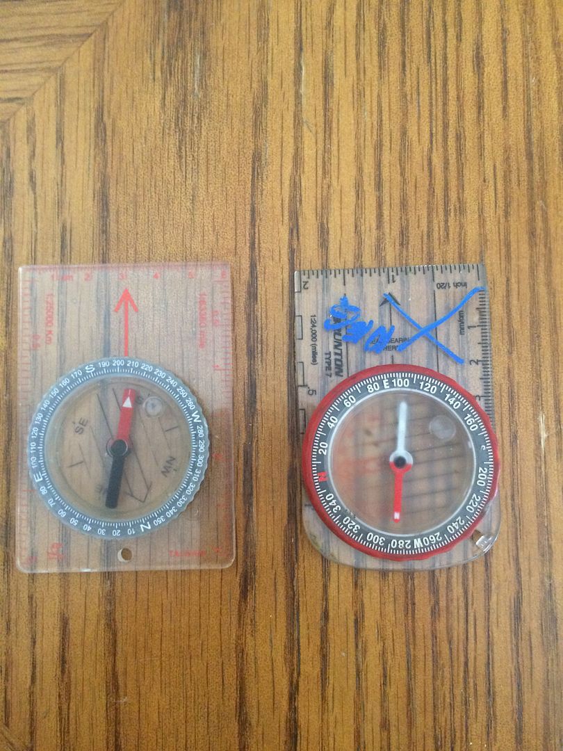

Do any of you fellas know the procedure to resetting a magnetic compass. One of mine has got itself so the south white end points north so she out 180'. I know there is a way of resetting it with a magnet.
I tried putting a rare earth magnet on the work bench to the north and setting the compass so the red north end is attracted and pointing to it. I left it that way for several hours but when one removes the magnet the white end swings around to the north.
Anyone out there know the trick to doing this??

I used a rare earth magnet. One end/side will attract the north end (red) of the needle. The opposite will repel it. Opposites attract so it is the south end of the magnet attracts the red (north) end of the needle. Place the magnet so the red end of the needle is attracted to the magnet, about a inch away, and leave it there. It took several hours before the red end of the needle started to stay pointed to magnetic north in my case.
This had happened to a couple of my large Silva compasses years ago and I sent them back to Silva and they corrected them so I new it was possible, and was told at the time they reorient them with a magnet.
In each case this one included it was the magnet closure on the flap my hunting coat that damaged these compasses. I have long since removed the magnets from the coat pocket flaps. This small compass was damaged and I hadn't used it in many years so I hadn't noticed it was disorientated.
Had the same issue. My compass was in a small tote in my back seat with a magnetic rooftop antenna. Got out of the truck to take a bearing on a hill and realized right away that something was very amiss.
Glad I noticed on the road and not while trying to navigate in the woods. I just held the back of the compass near the same magnet on the antenna and it reversed polarities again.
