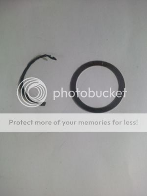

So a few weeks back my M305 started having its groups open significantly and I started to see significant stringing. Thought it was just a barrel tension issue (the receiver is in a Blackfeather stock and I've been playing with the barrel tension). So after much ammo downrange and no improvement I tore the rifle down to see if I could detect an issue. To my surprise, the gas system shim had disintegrated.
The shim on the left is what was left, the shim on the right is a new one.
