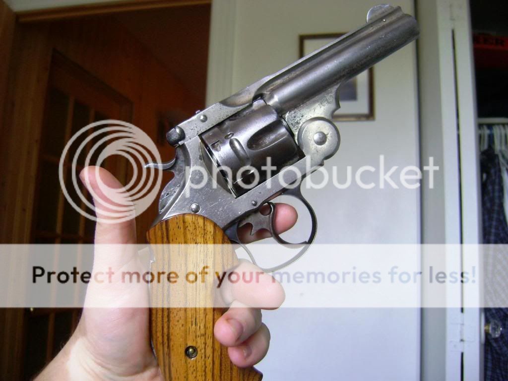

And finally... the iron in question is a S&W First Model DA in .44 Russian/.44 Special, circa 1890 or so. The gun is in a near perfect shape and can chamber .44 spl due to it's longer 44-40 cylinders, but needs reduced loads (hence the light Horandy bullets I bought to reload it combined with small amounts of Unique). Picture:
