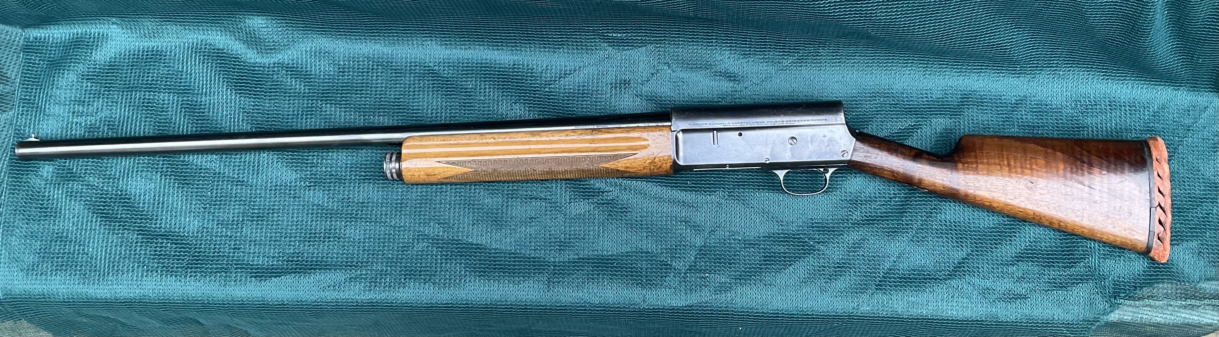

Here is the shotgun when I acquired it. The buttstock is original but was shortened to accommodate a Rubber recoil pad. The forearm is post second war.

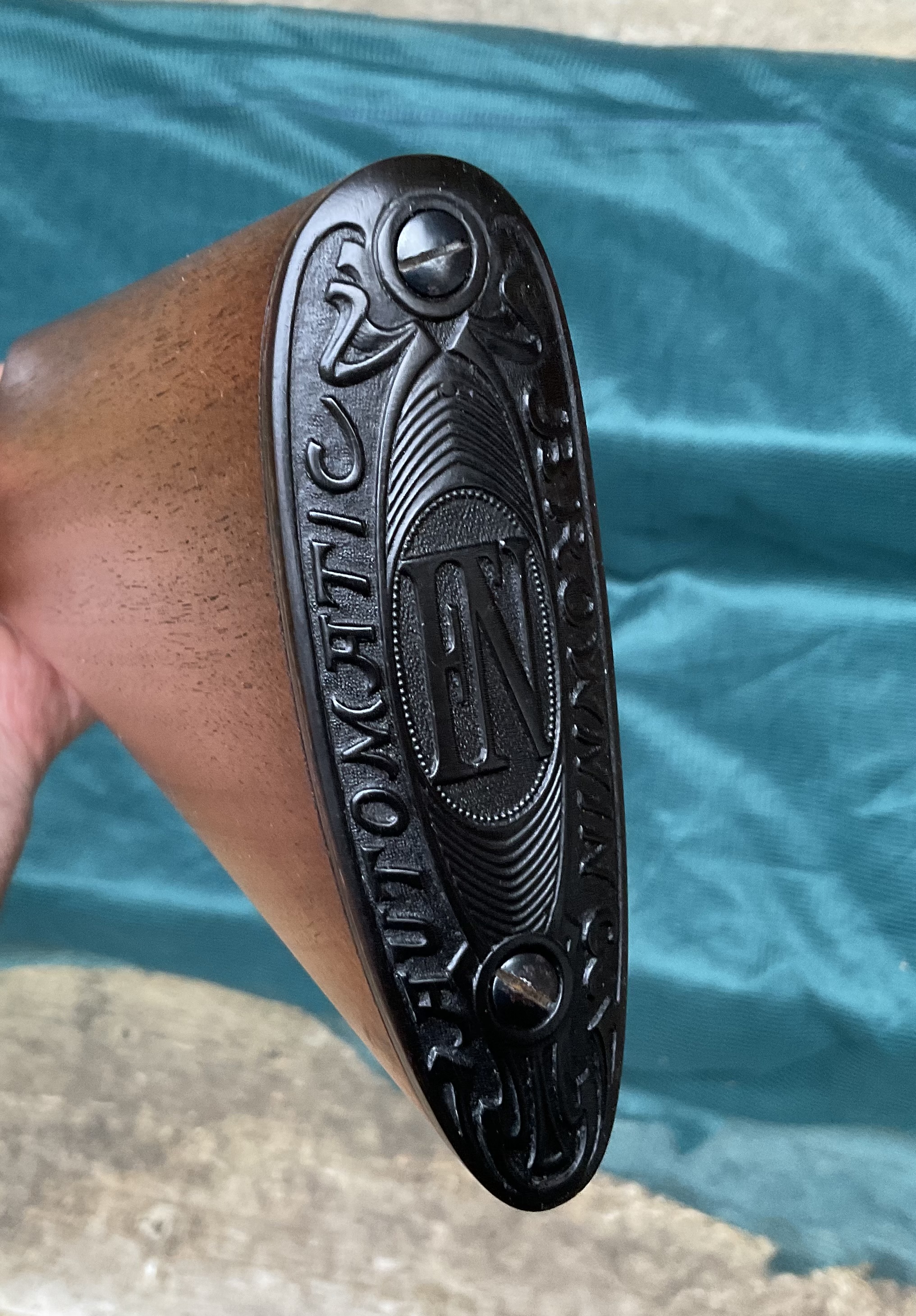

The original buttplate was made of hard rubber. It is extremely rare to find a pre 1909 with such a buttplate. The 1909 I installed on this Browning has the exact same look but it is made of water buffalo horn. I reworked it and polished it.
