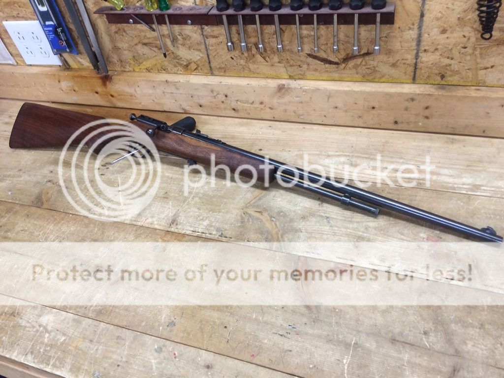

Never had a problem with cold blue... Here is a pic of my dad's old Cooey that I redid..... Was the first real gun I ever fired......
I didn't say you couldn't get very good looking results with cold blue because, yes, you can . I have done it to a few guns and they look great. However, it is not a durable finish and most will tell you that. I switched to slow rust bluing after being told about it by a few people. It is the way it was done back in the day and I have never looked back. If I am going to the trouble of stripping a gun and doing the necessary prep, I want to put something on that is longer lasting than cold blue, especially if the gun will be subject to various kinds of weather. I know if someone is selling a gun and they tell me it was reblued using cold blue, I walk away unless I'm prepared to redo it.But that is just my opinion and to each their own.
Your rifle looks great by the way.

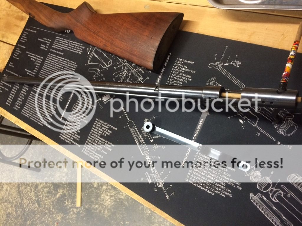

I use birchwood casey cold blue with excellent results , did 8 coats here is the steps / materials I used
- clean cotton rags and cotton balls used to apply the blue , do it in small sections in short streaks .
- fine steel wool
- heat gun
- methyl hydrate ( used to clean between coats and to de-grease ) can buy this in most paint sections at Canadian tire stores etc..
- Disassemble clean , clean clean , and when u think its clean , clean it again .. prep is everything !
- Once its clean heat the part / barrel up with a heat gun the blue will apply much better with some heat warm not too hot .
- Apply the blue with the cotton rag / swab then get the fine steel wool and buff out the finish
- Clean part/ barrel again and repeat the above steps 8 times or more until you get the finish you want .
- give it a final buff with the steel wool and let the part cure for 24 hrs before applying gun oil
Hope this helps any questions feel free to PM
