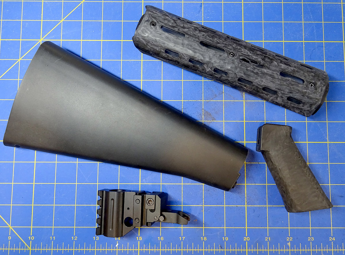

Some parts:

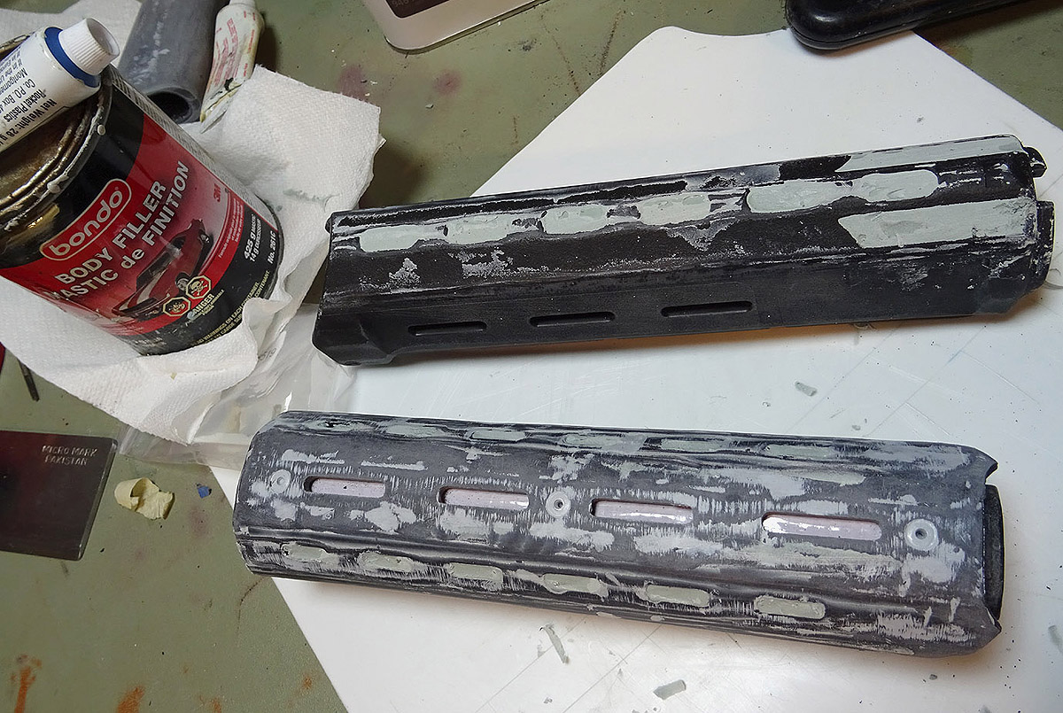

Some sanding and filler:

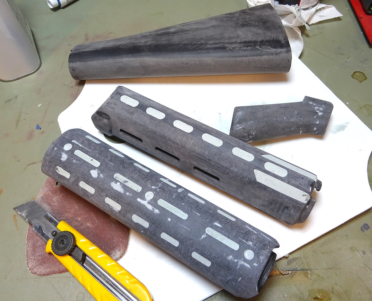

More sanding:

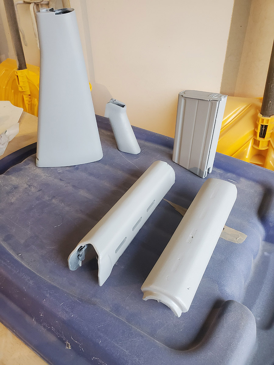

Primer Check...and looks like more filler & sanding!
