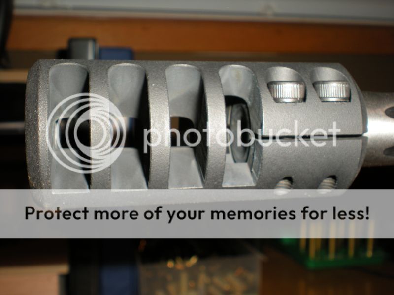

A couple of weeks ago I decided it was time to brake my hunting rifle, a Remington Sendero in 7mm Remington Magnum, for the purpose of off season target shooting (it’s not that I can’t handle the recoil, but after twenty or so rounds it does tend to get a tad old). But what route should I take? I looked into some of the options out there. Since I love the look of my rifle without a brake, I narrowed it down to a clamp-on type brake.
I already have a brake from Coretac Solutions on my Savage 110BA in .338 Lapua Magnum and I am very happy with its performance. I purchased that brake due to its smaller size compared to the factory brake and with the additional ports, cuts down on some of the heavier recoil produced by the 300 grain projectiles. This is how I arrived at Coretac Solutions, but I digress…
These brakes are made to order, so, after placing my order it took about three or four business days to machine, coat and ship my new brake. I had it about a week after it shipped.

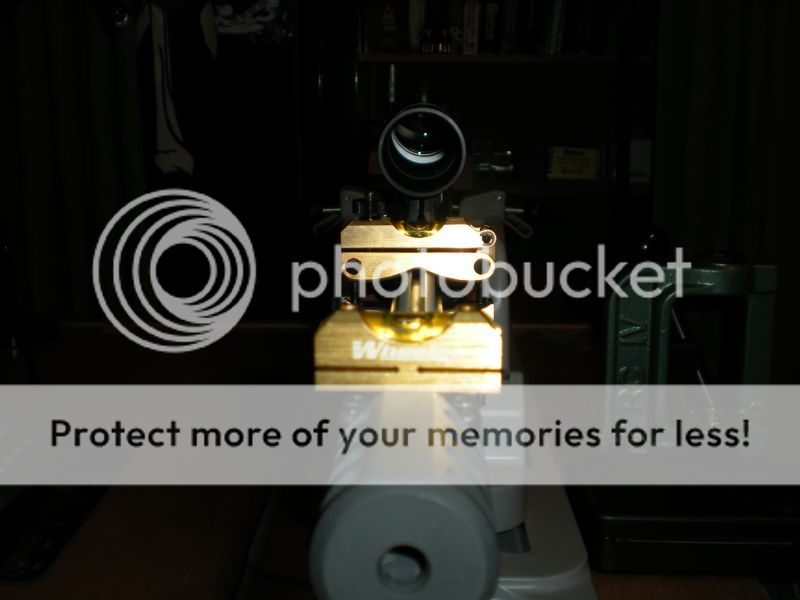

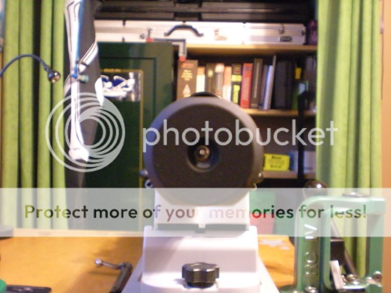

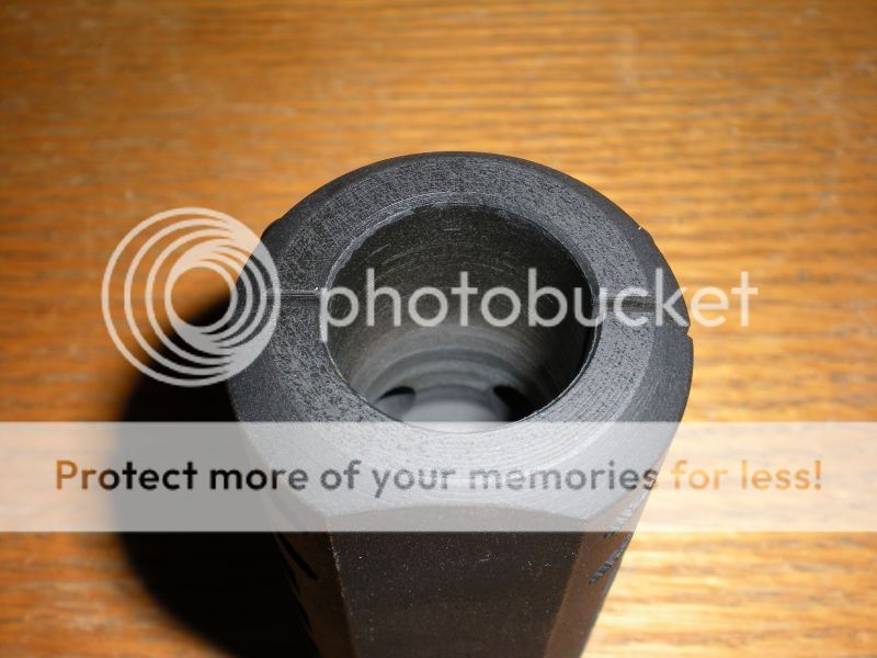

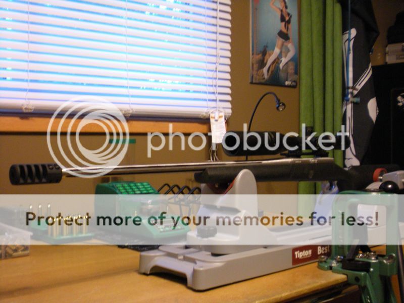

Upon receiving the brake, I must admit, I was pretty excited to install it. Once I got it out of the package, I looked it over for any burrs or debris, it was clean. I pulled out my digital callipers and checked the dimensions of the unit and compared them to the numbers I gave them. Bang on. I retrieved my Sendero from the safe and set it in the tipton gun vice and levelled the rifle. Slid the brake over the muzzle, it was a nice, snug fit. Set it at the stop, levelled the brake and torqued the studs to the specified 85 in-lbs. I then pulled the bolt to look down the tube to check for obstruction, clear. With the bolt still on the bench, I visually checked the alignment of the brake to the muzzle. The muzzle appears to be right where it needs to be.
