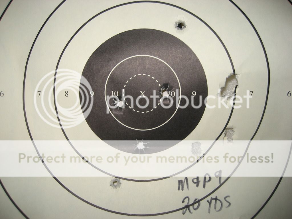

I cant a handgun slightly, so it will group left unless I adjust the sights. So before going to the range, I adjusted the rear sight about 3mms left. Groups were on paper, so I was able to test it for grouping ability with three power levels of ammo. I shot at a fairly fast pace at 20 yards. One shot every 5 seconds. It grouped well.
That is the good news. The bad news is that I was aiming at the target above the one I hit. It shoots 5” low. My M&Ps, out of the box, also hit low, so I had to replace the front sights.

I am showing both the 3.3 and the 3.9 to emphasis once again why it pays to try a variety of loads, to see what a gun likes. There is usually a clear preference.
20 yards - 2 hands
That's a remarkable difference, not reloading myself I had no idea .3 grains would make such a difference. Are loads of different powders also as crucial? (you said you're using Titegroup here)
That difference is 0.6gr, which is a significant difference with TiteGroup. The accuracy difference in this case is the biggest I have ever seen, but every gun so far has shown a favourite loads and loads that were NG.
Handloaders often try to make the hottest ammo they can, and thus miss the accuracy potential that can be found by trying a range of loads.
