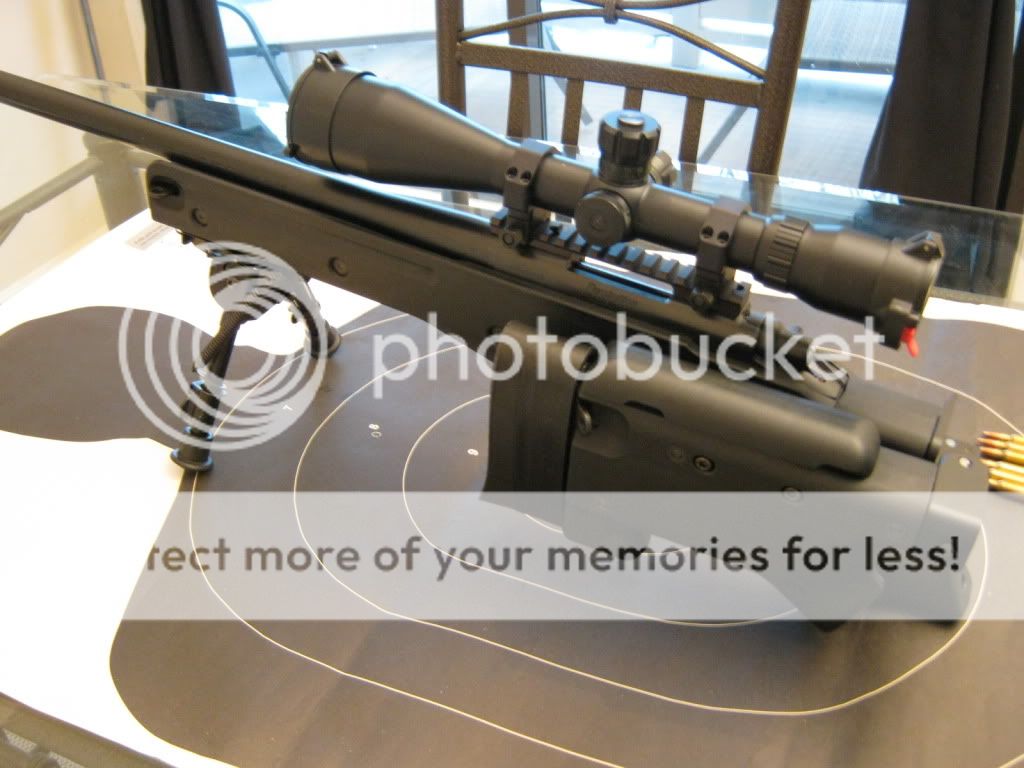

This rifle was also purchased new and, partly because I have a standard 26" TRG 22 already, it is the rifle most familiar to me. Black (Sako calls it 'Stealth') metal work and the relatively new desert tan coloured standard Sako stock. Chambered in .308 and made by Sako in Finland.

Sako : Retailing at approx $3,200 the rifle comes with one detachable staggered 2-row ten-round magazine. Threaded for a brake, it doesn't come with one but you do get a thread protector for your money. A pretty comprehensive ( multilingual ) owner's manual, bolt tool, various sling attachments and a set of Allen keys round out your purchase. TRG's now come in a nice hard case and have a scope rail attached to the receiver - only complaint about this nice bonus is that it isn't a canted or sloped rail but that is a relatively minor moan.

Sako : The stock is an aluminum base to which a polyurethane clamshell forestock is attached. Adjustable for length of pull and with an adjustable cheekpiece (including a cool lateral adjustment).
I find it disappointing that some additional spacers (not cheap) are required to take full advantage of all the adjustment capabilities. Designed to use Sako's proprietary bipod, the stock does nevertheless accommodate a Harris or similar. Sling swivels and attachment points allow for you to carry this rifle slung pretty much anyway possible. A push feed system - with an oversize bolt knob that is, annoyingly to me, made of some polymer/hard plastic - with a 60 degree bolt throw which is nice for fast operation. The trigger guard is (like the Sako, Coyote and Accuracy International or AICS) large enough to allow for gloved operation. The trigger is a military-style two-stage and is easily adjustable without stripping down the rifle. Trigger can be adjusted for pull (as low as 2 lbs), length, vertical and horizontal pitch. The standard TRG has a 26" barrel which is cold hammer forged and is free floating with a 1:11 rate of twist and this 20" version has the same ROT.

Sako : This rifle has a look that people either love or hate - I'm a fan of the look as well as being appreciative of its functionality. More commonplace now than they were a few years ago, these rifles still get some attention at the range. Mine was perfect in every regard when I picked it up from Reliable Gun and Tackle here in Vancouver. Consistent with my other TRG, there wasn't anything that could be nit-picked about it with respect to either the metalwork or the stock finish.

Sako: Listed as weighing 10.3 lbs the rifle as tested weighed just a bit under 14 lbs because added to the rifle's book weight is a scope, rings, Harris bipod, Blackhawk cheekpiece and empty magazine. Even though it isn't a lightweight this is a carry-able rifle - the balance point is much better than its' big brother with the 26" tube. As with big brother, I have shot hundreds of rounds through this rifle both at the range and in competition and I am impressed with its smoothness, and the overall 'feel' of the rifle. Sako's trigger is a joy to use - I like military-type triggers - and I have adjusted this one to be a perfect fit for me and it lets off at an even two pounds in a totally consistent, repeatable manner. Sako's bolt is super slick and the 60 degree throw allows for fast rapid-fire drills but the Sako ejectors need watching as anything less than a smart pull back on the bolt will leave a spent casing sitting on top of the magazine follower which requires a quick 'mag release and clear' movement. Sako's mag inserts, feeds and releases perfectly and I like the double stack as it keeps lines smooth and allows for a mag change without moving the rifle off target. As I said in my previous article that featured a TRG the cost of accessories is my biggest complaint about our Finnish friends -spare mags cost $300+ and the Sako bipod cost nearly $700. Regarding bipods, a #6 Harris adapter costs $11 and a Harris costs just over $100 - need I really say that both my TRG's wear Harris' :)

Sako : Nightforce NXS 5.5-22x50 MLR Reticle Mil/Mil turrets. TPS (steel) HRT rings

Sako: 0.372" (no appreciable spread, biggest group 0.505" - all groups inside a dime.) For the reference of readers the 26" version produced a 0.176" best group when it was tested for Part I of this review.
