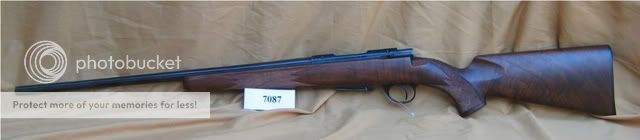

I thought I would share a review and range report on the Anschutz 1730 D 22 Hornet (discontinued). After an extensive search for another 22 Hornet to try, I had narrowed the field to a Ruger 77/22 Hornet, CZ 527 Lux, and an Anschutz 1730. After asking the fellows here about the hornet, I decided against the Ruger (but I am reconsidering this rifle now based on my recent experience with the 77/17) and almost picked up a 527 Lux. As fortune would have it, the EE offered me a chance at an Anschutz 1730 without having to pay over 2k for it. It was an extremely low round count used rifle but I was willing to take a chance on it. When it arrived I put a Bushnell 4200 2.5-10x40mm scope on it and put her away until this weekend. So the actual review of the rifle:
The rifle fit and finish to say the least was spectacular, when you pull it from the styrofoam box, you can see that the inletting and wood is fantastic. The bluing is beautiful and the rifle is a definite eye grabber. What I did notice off the hop was that there were no sling studs mounted onto the stock. I was not overly impressed that a rifle marketed as a match grade "hunting" rig did not have such a basic feature. I did notice that the ones Prophet River sell do have the studs but that didn't help me so I went to the gun store and picked up a set and glass bedded them into the stock. Except for the sling studs, I would say this rifle definitely qualifies as a premier factory produced rifle. Here is a pic of the rifle:

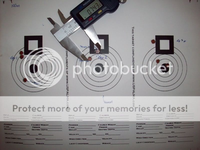

I quickly loaded various loads of lil gun and 3 different types of bullets and hit the range last Friday. When I got to the range, I pulled the loading box, which had tipped over during the drive, out of my range bag and discovered that all of my carefully prepared loads were mixed. After taking 10 mins to calm myself down, I decided to use the ammunition to at least zero the scope. I quickly discovered that the range of powder charges and bullets made for holes all over the target - in short Friday was a bust. All I knew about the rifle was that it could hit paper at 100m (sometimes) and that the ejector/extraction system on the model 54 was a bit on the lame side, sometimes rounds would fly out, sometimes rounds would fall back into the ejection port, and other times the bolt would not pull the round all the way out of the chamber. I was not overly impressed with the action on such a high end rifle.
Friday evening, I modified my loading boxes by adding Styrofoam to the lid to hold the rounds from falling out of the box and proceeded to reload the same data as I had used on Friday. I cleaned the bore and rifle and eagerly went to bed. Saturday morning, I went to the range and set up - the winds were blowing mildly and it was spitting a little bit of rain. I proceeded to fire every load and in short, I was furious with the results. Not 1 load would group better then 1" at 100m (I have over 12 different mixes), the best load was a Hornady Vmax 40gr over 12 gr of lil'gun at about 1.5" which I had to singly load. It was total s***, when I got home I was fuming. To have spent the kind of money I did on this rifle and seeing the crappy results really ticked me off. After watching a bit of "The Simpsons" to calm me down, I decided to review my load data and look at the rifle. The load data lined up with everything that Hodgon recommended and what every i-net site webpage recommended, so I knew that the data couldn't be bad. I decided to look the rifle over carefully, the crown checked out as clean, the barrel looked straight, the action wasn't stressed, and the barrel was freefloating. Compared to the test target, this rifle was out to lunch, I then undid the action screws and pulled the barreled action. I then discovered that Anschutz didn't bed the rifle. WTF? Bedding is pretty common practice and for the life of me I couldn't figure out why a wood stock action had no glass or pillar bedding. So last night I cleaned up the stock and glass bedded the action with a kit that I picked up in Edmonton during Thanksgiving. Today, I loaded the same data and went out and shot it again this morning. This was the results:
In short, the rifle is shooting very well. I found that as the lil'gun load approached 13 grains the rifle would shoot better. So what do I have to say about this rifle?
For the price that you are paying, I don't feel that you are getting a product that is worth the price. Maybe I am spoiled by custom gunsmithing but if you are going to drop over 2k for a factory rifle, it should shoot and function right out of the box. I realize that my sample is impossibly small but to me that is the whole reason you are paying more so it isn't a crap shoot. It is quite obvious, that Anschutz pays a great deal of attention to their workmanship. Quality of manufacture is there, the barrelling and action are well mated. What I don't understand: Is why simple things which affect accuracy weren't done and why is the ejector/extractor system so cheesy? Almost every other rifle I owned (some which cost significantly less) would throw spent brass with authority, this rifle dribbles them out, leaves them in the chamber or flings them at other times - I am going to troubleshoot that tonight but from what I am reading it is a pretty common issue with the 54 actions. In total, I am happy that this rifle can shoot but I am not happy that I had to do any work on it. Sorry for the long post but hopefully somebody looking at an Anschutz finds this review useful.
