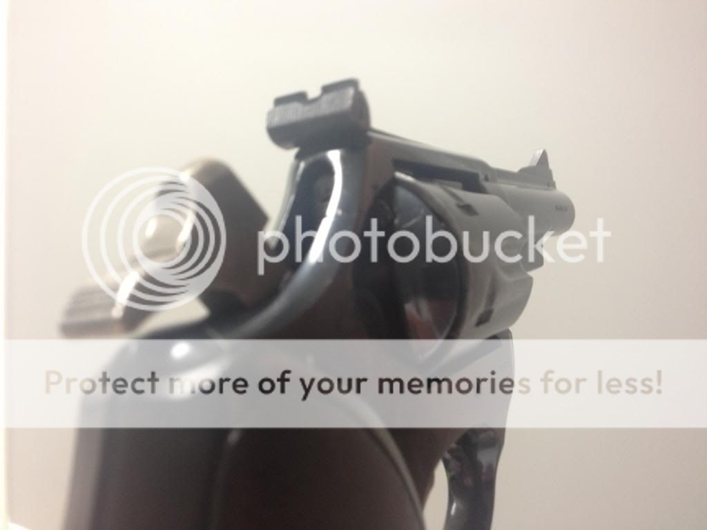

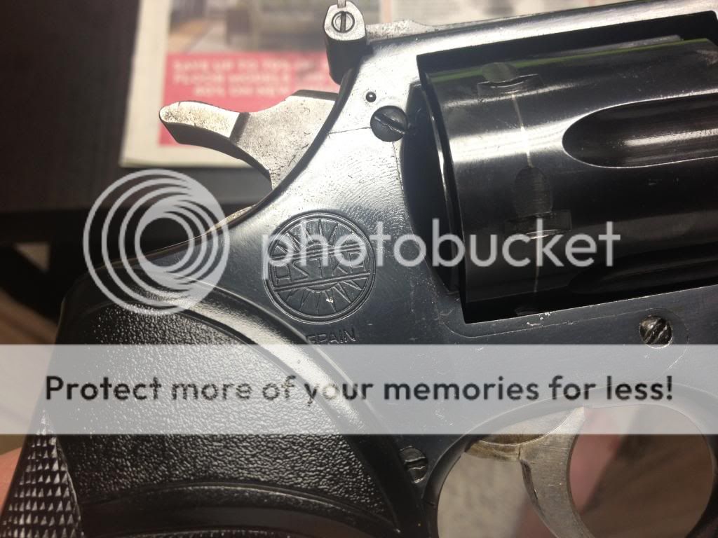

I'm finding it hard to believe a firing pin made the dent like that in a brass case.
It happens.
With the gun out of time, its probably caused by a worn hand, but it could be a worn bolt or worn cylinder stops as well. If the OP intends to continue using it, he needs to advance the cylinder by hand to ensure it locks in place, and fire it SA only. I bought an old Colt Army Special that was out of time and I had no problem as long as I advanced the cylinder by hand to ensure it locked in place. After having the gun for some time, I've only now sent it out to get fixed . . . it might almost be done I hope.

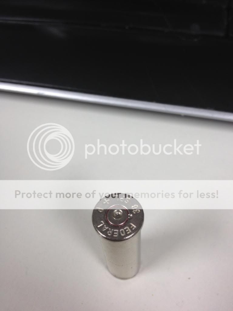

This is what my 625-3 was doing: (identical to you) These are practice dummy rounds in a moonclip with the spent primer seated back in.

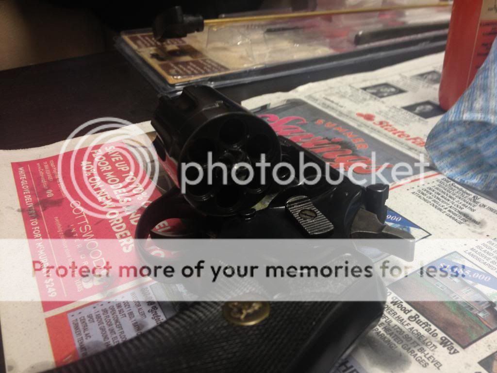

Cylinder Stop was replaced and hand fitted.
(sorry, don't know the exact part name) Black line points to the part.
