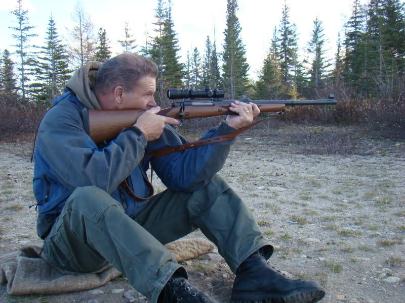

I favor the Galco Safari Ching Sling, but given Galco's shipping policies, and the state of the Canadian dollar, they are not an inexpensive option; I consider them worth the expense and have 4 of them. They are fast to get into and get out of, all that is required is to pull the horseshoe strap up on the back of your support arm with your shooting hand, and if properly adjusted it will stay put until you ease your grip on the forend of the rifle.
Since you already know about slinging up, I won't go into the advantages except to say that it works from supported shooting positions, since it anchors your support arm to a solid surface, but is of no value when shooting off hand despite many opinions to the contrary. If you think about what slinging up does, there is no reason for it to work off hand. But when slung up from prone, sitting, or kneeling, the rifle holds solidly on the target, and you will hit accordingly. When shooting off hand, if you tense your stomach muscles, the moment before you press the trigger, your sights will for a moment hold dead solid, and if you can break the shot in that moment you'll be rewarded with a hit.
Safari Ching Sling . . .
If the sling adjustment is too loose, the sling will not stay in place, but if too tight, but it will be difficult to place the butt into your shoulder, so take the time you need to adjust the sling correctly for what you're wearing . . .
