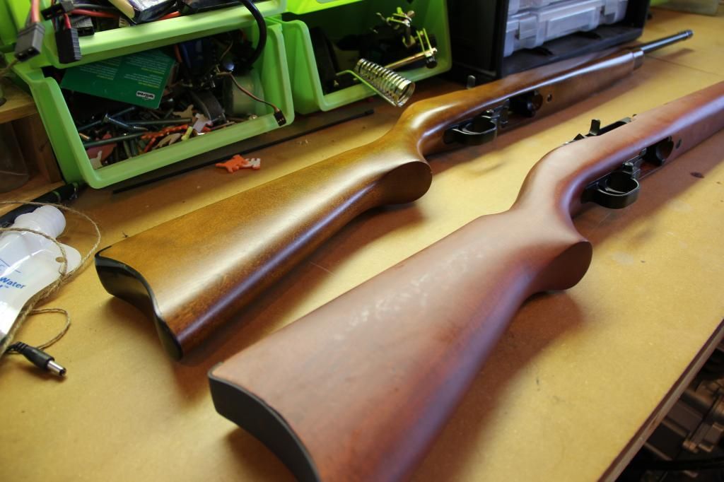

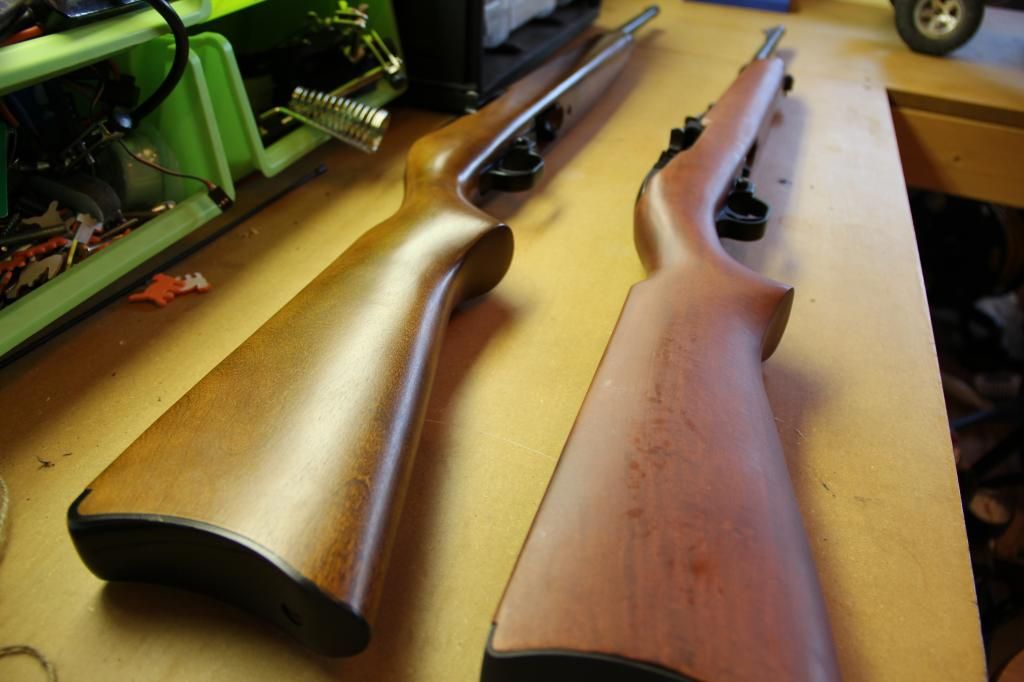

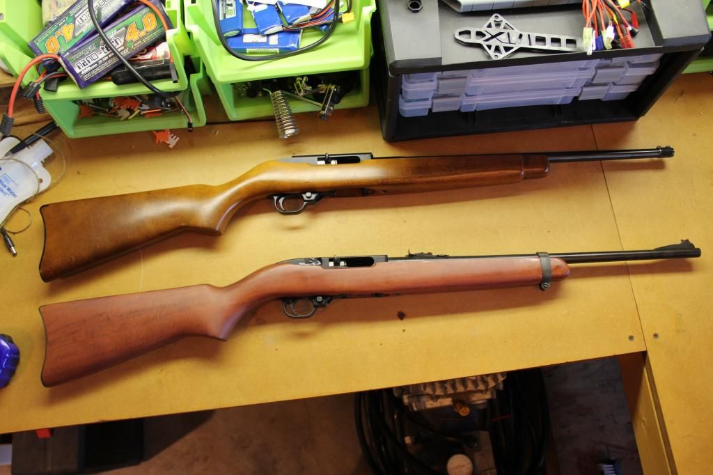

1) The wood stock on the M22 looks terrible (see pics). Ruger has nothing to worry about if they're concerned someone is copying their stock as it's pretty apparent which is which

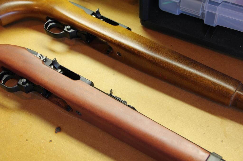

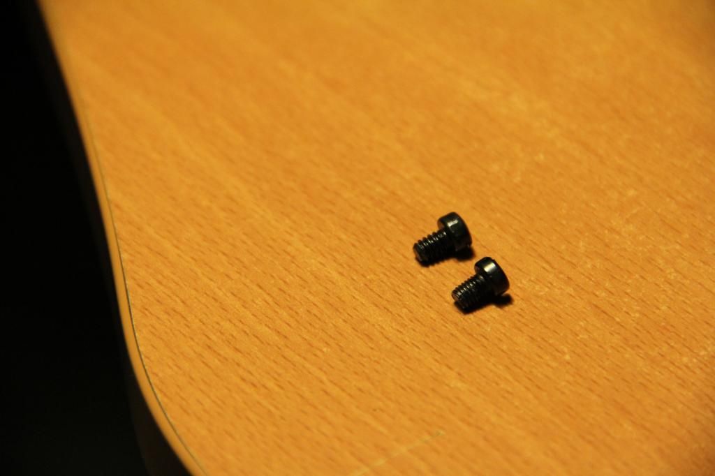

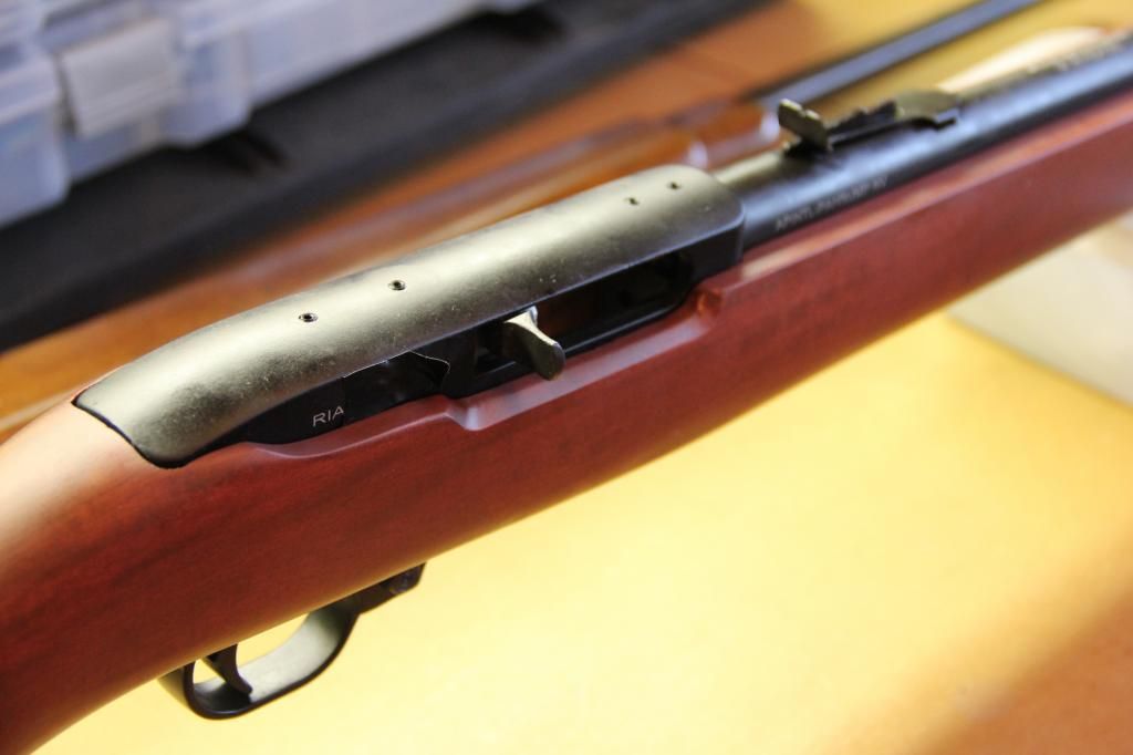

2) The scope rail is removable (There is another thread regarding the G36 stock and whether the rail would interfere with installation). One thing to note is that the screws which hold in the rail are of a coarser thread than on the Ruger (see pic).

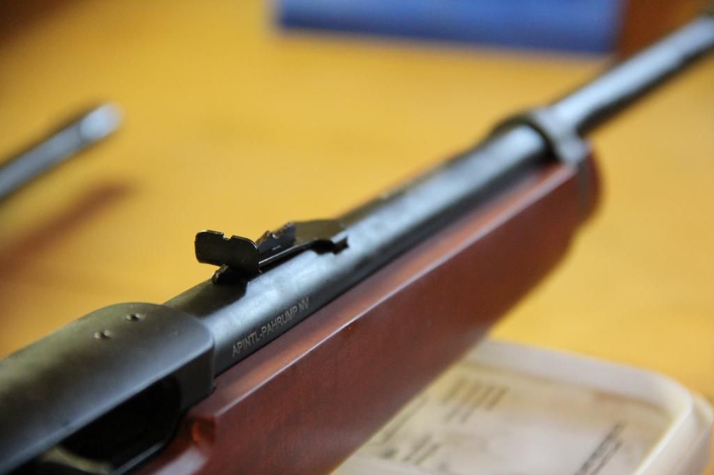

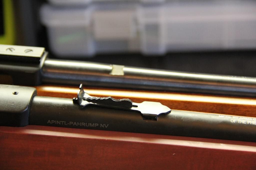

3) Rear sight is ugly and does not contain fiber optics (although the front sight does). If you see the pic, the vertical piece that the rear sight fits on was bent to the right (when looking down range). I have no clue how to adjust the elevation but assume it has to do with the stepping along that vertical piece. Windage I'm guessing is adjusted with a drift punch. I have not shot this gun yet so no idea how straight the M22 shoots. As for the cockeyed vertical piece, not a big deal to me as I'm planning on mounting a scope.

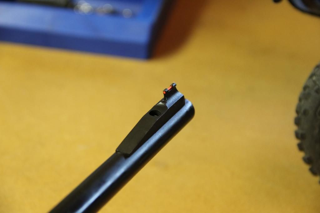

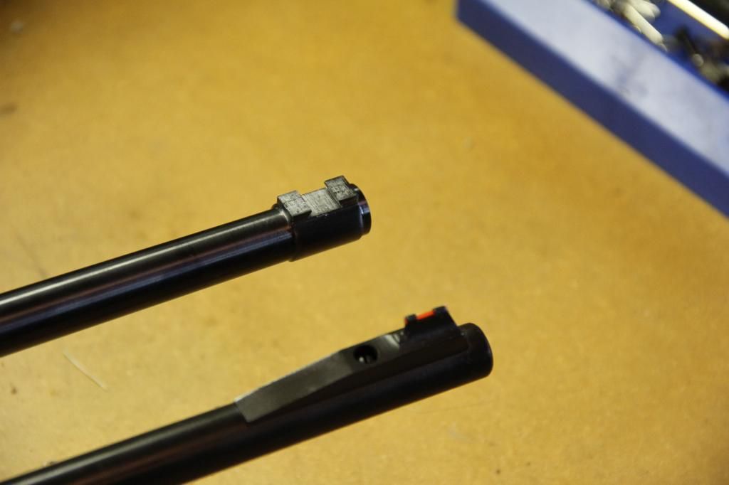

4) Front sight is mounted on a ramp held with a single screw. I have not removed the sight but i suspect that mounting any compensators (referring back to the G36 thread) will require some work as the barrel's diameter will be too small once that ramp is removed.

6) I have not taken apart the gun but some quick dimensions I have looked at are identical to the 10/22 (OAL, receiver length/width, barrel OD). My calipers are not as uber precise as some others I have seen to compare the two guns. I read that the barrel tang on the M22 is not the same size as the 10/22
7) Fasteners on this gun would have to be looked at very carefully as I'm thinking that the M22 might use metric screws.

I'll bring it out shooting some time next week to give thoughts in that area...otherwise enjoy the pics...10/22 is on top, M22 is on bottom

So far my list of things that don't interchange are the barrels, take down screw, and scope mount holes....barrel stubs are different diameter, threads are a different pitch. Not much modding to be done with these rifles.

2) barrel and front sight. You'll need to add something to up the OD of the barrel if you wish to mount a compensator

Seeing as you usually don't change the scope mount screws or takedown screw, I don't see how that would constitute a problem. The barrel stub IS a different diameter, true. It's not hard to sleeve a barrel stub either, though. AFAIK all of the internals will drop right in. So there is, in fact, a lot of modding you can do to these rifles, even without sleeving the barrel stub on any replacement barrels.

1) The scope rail mounting holes, for my rifle, seem to be threaded the same. I have Kwik-Site see through rings on my rifle and the supplied screws installed as they should. The included dovetail is still in the package but yeah, it looks really crappy.

3) I had played with a few 10/22s in other shops and for me the RIA's open sights are miles better than a Ruger, with the fibreoptic bead. OP is correct that the little shim under the sight is for adjusting elevation, a lot like a pellet rifle's rear sight. The front sight kept coming loose out of the box but a dab of loctite fixed that.

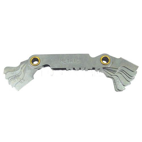

Nobody makes "proprietary" screws any more. 10 seconds with one of these and you'll know what screws to replace them with.
