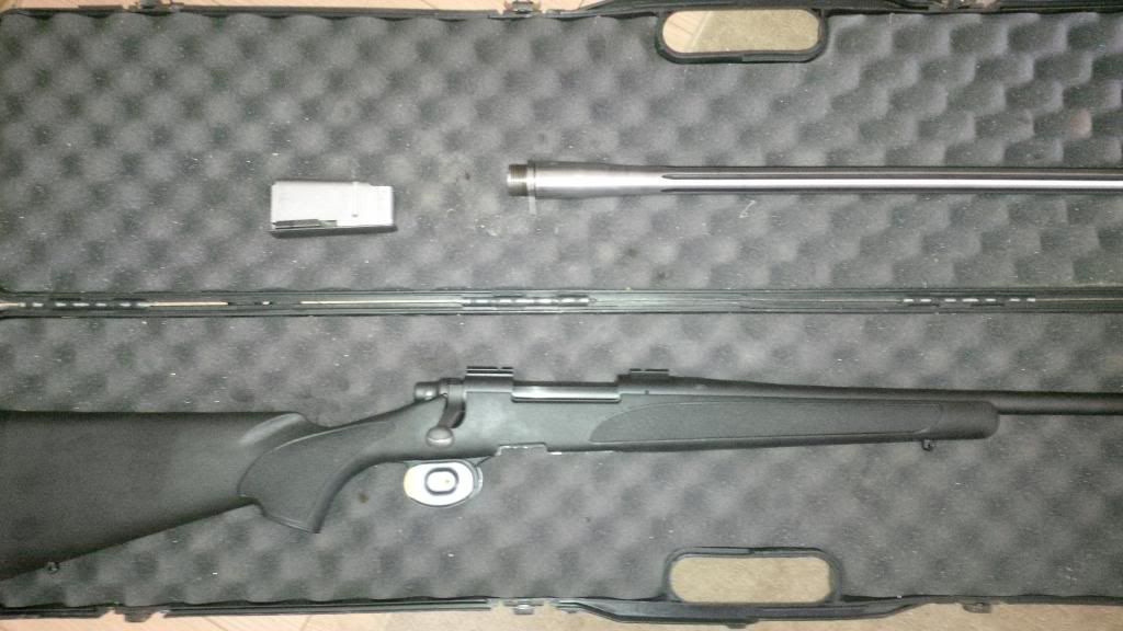

Well quick update; the rifle and barrel have arrived. Nothing overly fancy as of yet but here is a bad cell pic. It will be off to the Gun Plumber tomorrow for it to come to gather, and the stock should be here this week.
samsplacci71; Thanks, Ya its hard to stay within my budget idea when it comes to optics that is why I am going to wait till it is fully assembled to make my choice. I am though forcing myself to stay within this budget though, I think it is possible. No plans on a brake, rather spend the budget on the optics, never really had too much problem with the heavy hitters personally, but it won't be the 70-100rnds in one sitting of course. Most of my long range is prone off bi pods, or my eberlestock G4 with built in rest and a sock for rear support for both supports. I have a farm I shoot at and I have to carry everything in to get the distance shots.
Will keep you all posted as it comes together!
