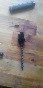

Well, I took it apart again. I somehow managed to decock the bolt once it was out of the body and now I can neither remove the bolt shroud, nor thread the pin into the bolt body.
Serenity now...

Trigger work & liabilities.⚠️ Heard of a similar rifle that inadvertently fired when bolt handle was lifted because of a certain loose fastener. Sage advice & always keep muzzle pointed in safe direction.
