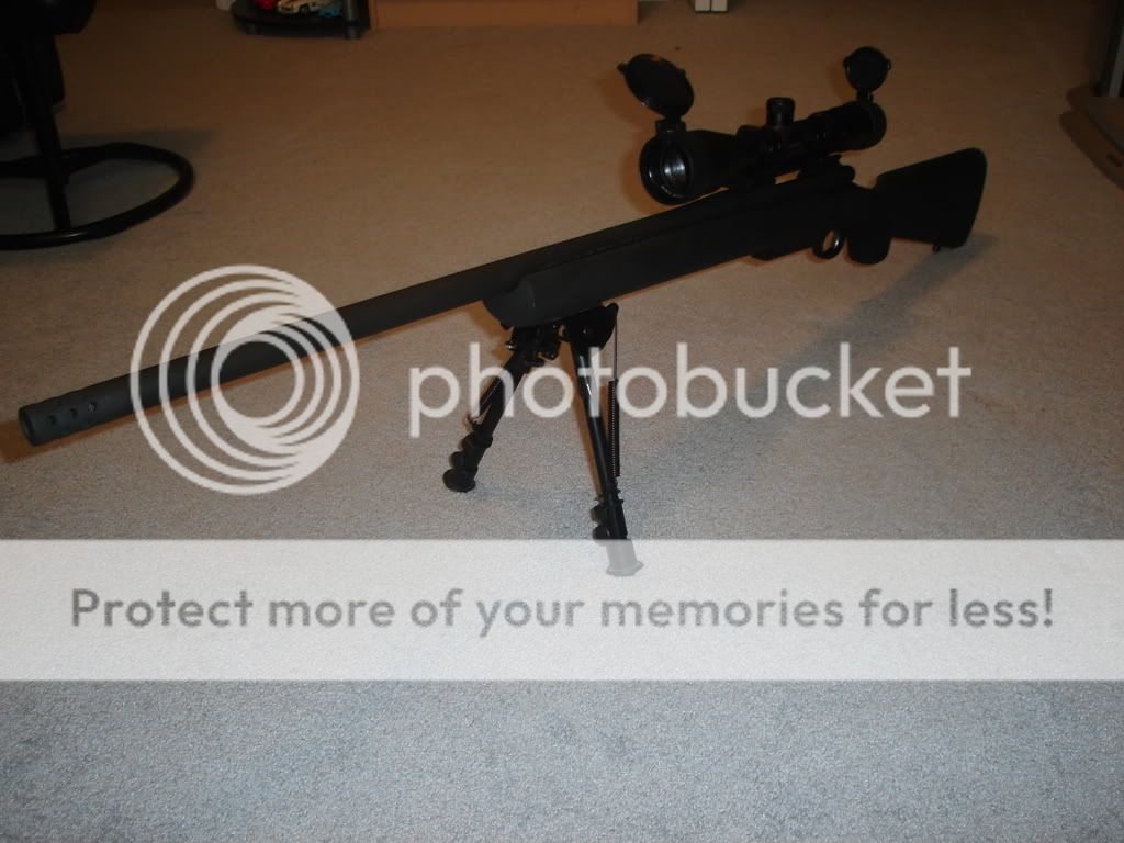

Current main rifle. Weatherby Euromark in 7mm Weatherby Magnum. TPS rings. Picatinny rail. FalconMenace 10x. Homemade anti cant device. Yeah, the rings are a little high. I can get a bigger scope down the road.

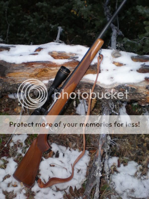

My current barrel is a Gaillard (which is shot out) and I have a new MacLennan 28" that I need to chamber and install this winter some time.
