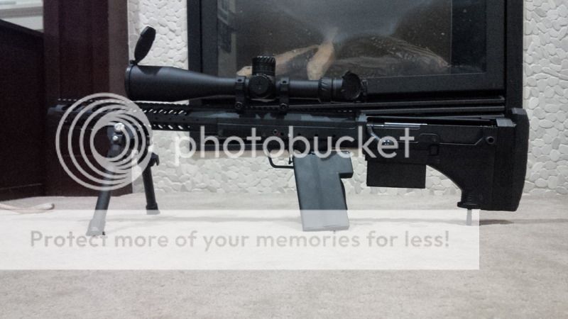

S&B PMII scopes come with bikini covers. I would say they are about 2mm thick (see pic).
Tenebraex covers are quite bulky and will require more clearance.

Probably not going to get flip covers as I can't convince myself of use of them.
looking at the posted pics of the tenebraex i will likely go for the 1.375 rings
Thats the size rings im using my with TT with tenebreax covers. They clear with like 1-2mm but I have a full length rail.
