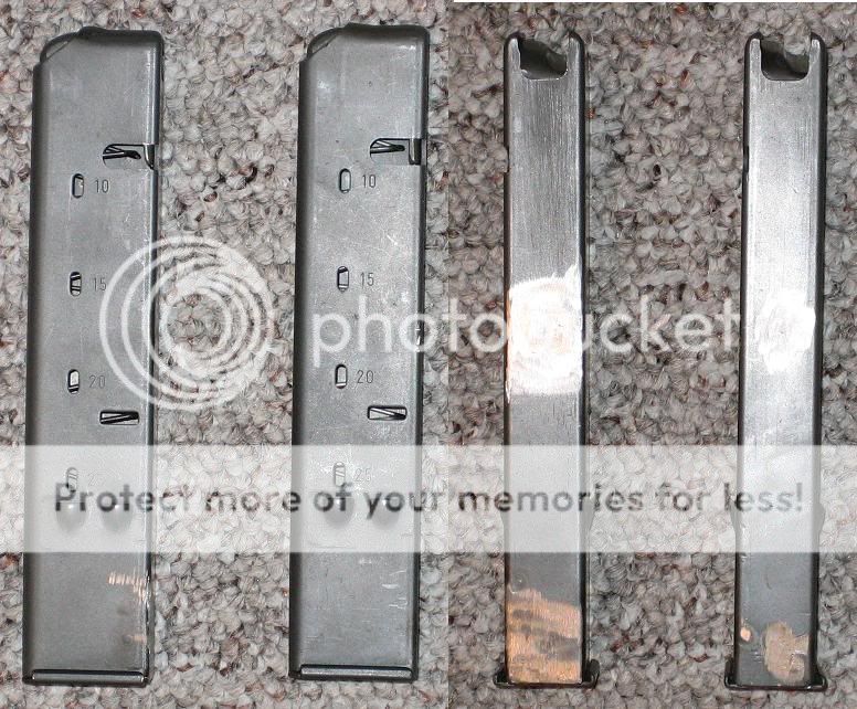

I have found that both the Gen 1 and Gen 2 metal bodied Questar mags are not 100% functional. They say that you have to fine-tune where the magwell sits in the lower, but I have found over the course of owning two 9mm AR's that this is fairly bogus - as just using the Pro-Mags will solve the problem by itself.
I used to have some converted UZI mags as well. I believe this is what the "Colt" mags are, or are based off of. The ones I had were real UZI mags and had no bolt-hold-open tab on the follower, and were like 80% functional (By which I mean they are terrible, 2 out 10 rounds malfunctioned in my experience).
My advice... seek out some plastic Pro-Mags. If you can ever find any of the 10 rounds, buy immediately and pretty much pay what the guy asks!

Oh man.. Questar had those mags on sale earlier this year.. I think it was 5 for $89.99.. I bought 10 and modified them to fit in Thureon.. So based on that fact, I don't think the Thureon mags will work in your 9MM AR.
