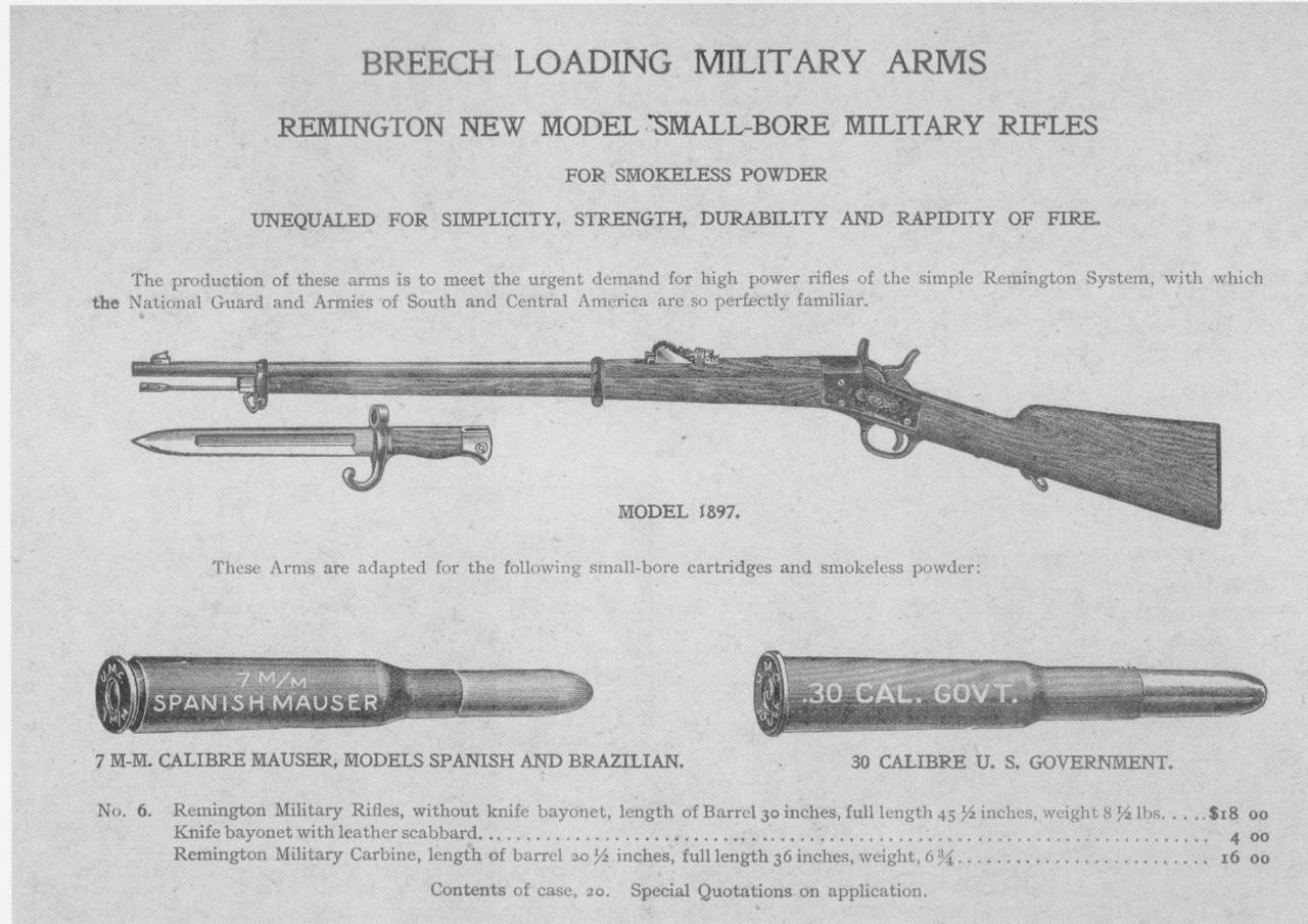

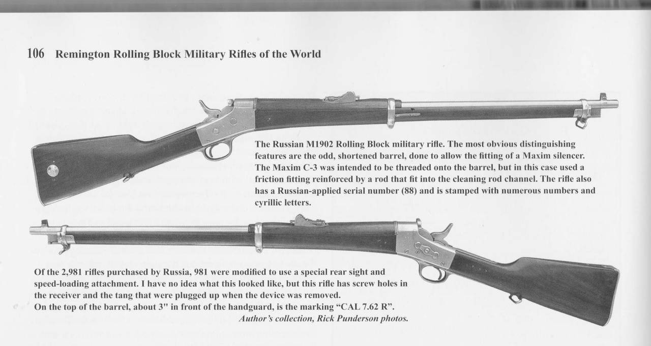

This rifle is commonly referred to as a model of 1902 or the model of 1910 Remington Rolling Block depending on which nation ordered them. It is also known as a No. 5 Smokeless action Rolling Block.
These rifles were mostly manufactured in 7x57mm Mauser for South American countries around the turn of the century they were also often chambered in 8mm French Lebel, 7.62x54mmR Russian, .303 British, .30-40 Krag and 7.65x53 Mauser.
This model has screws in a lower configuration than earlier Rolling Block rifles and was in production right up until WW2.
When Remington introduced a No. 5 Rolling Block essentially it was the same as the No. 1, but produced of much better steel designed for smokeless powder cartridges such as the 7mm Mauser, with some being chambered for rounds like .30-30, .30-40 and even .30-06.
In fact, it can be said the Rolling Block is solely responsible for pulling Remington's fat out of the fire. Remington and patent licence holders went on to build an estimated 15 million of them in total over many models.
And these 7x57mm rolling block Remington rifles were in service at the same time as the 7mm Mausers (M93, M95 and M98) were in wide use and used the exact same ammo and it was also loaded much hotter back then then to what it is now. A friend of mine used to own one in 7x57mm and he used it for decades as his deer rifle shooting factory ammo without any problems. I have also never heard of a factory made 7x57mm one exploding either.
