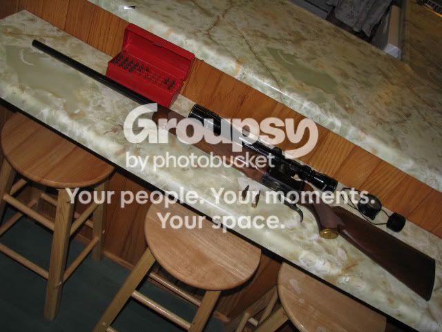

Falling block
I have built 2 vaultlocks one in 6mm BR and one i .308 and I have also built 2 of the chicopee design one in .22rf and one in 30/30, and found that they are really not that difficult to build, just labor intensive.
6mm br
[/IMG]
[/IMG]
[/IMG]
