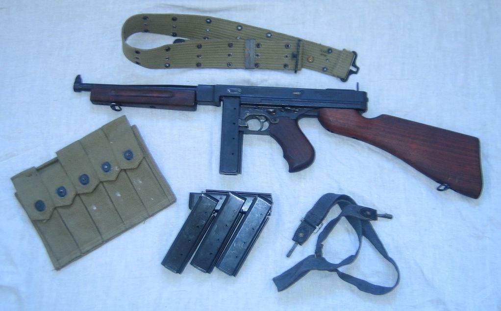

I recall Thompsons were sold with what they had been stored - German WW2 bradbag straps... $200 for a dewat, nobody wanted them... Every Tommy came with German strap, I guess they figured - why not, it would work fine as sling...
Actually I looked at my archive and still have pictures. This is the picture of the set I sold in Ukraine in 2010:

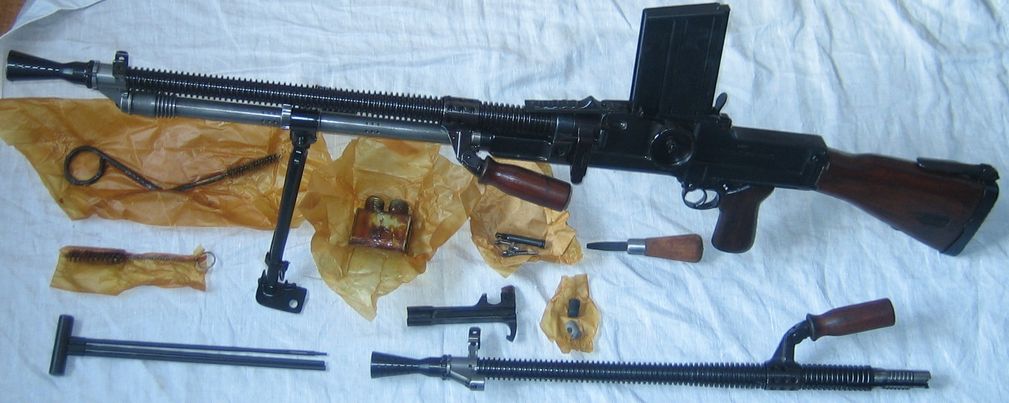

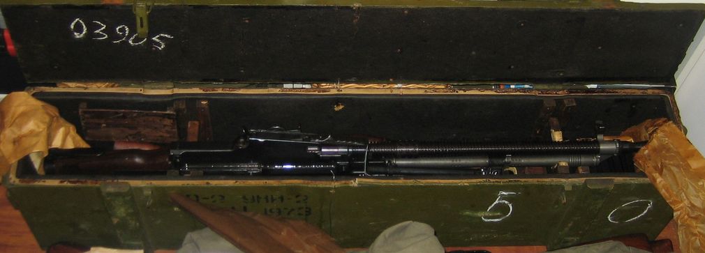

At the same time ZB30s came in transit crates with all spare magazines, spare barrel, parts and accessories... While crate is definitely Soviet, the content of original crate was still there. This is the one I sold in 2010 as well, sorry for poor camera pics. I can only guess significant amount of them was captured in unissued condition in crates.

Cool to see a picture of the ZB30 with it's original kit.

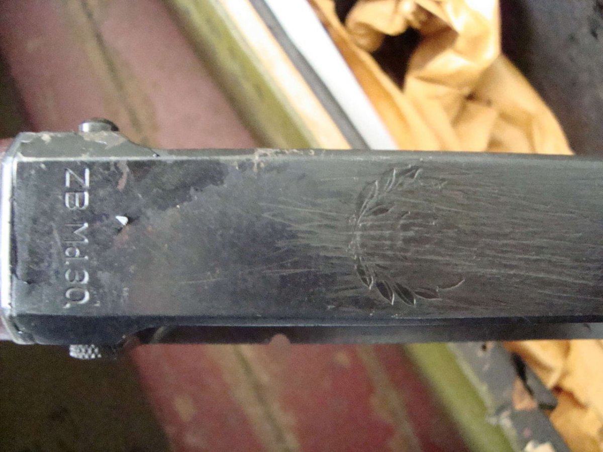

There were several types of ZB30 among the MGs stored in Ukraine, among them most common were two types: Romanian contract (with crest scrubbed by Romanians before they were captured) and "regular" ZBs with no crest. ZB26 and ZB30 were pretty common with Waffen SS. They sourced directly from CZ. The one I had had no crest.
