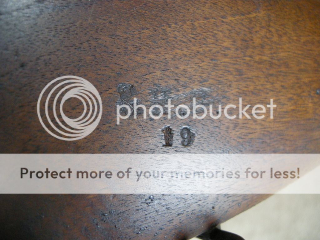

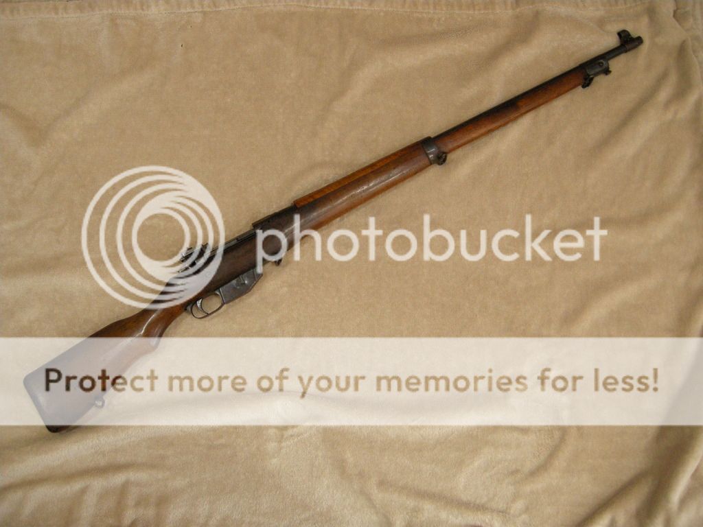

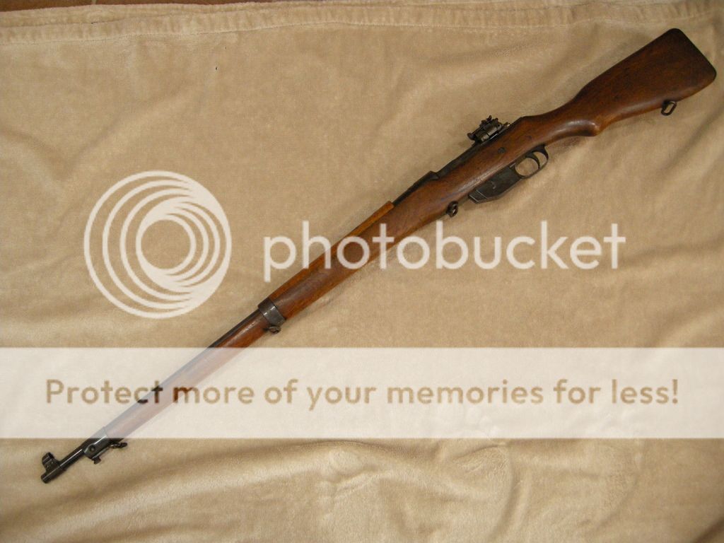

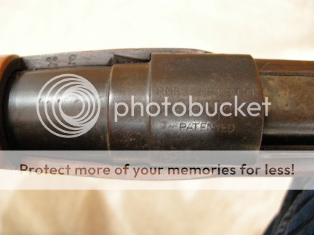

I just got my first Ross. It's a Home Guard rifle. Overall decent condition, all parts move. The bore is dark but rifling is good. Very interesting rifle.

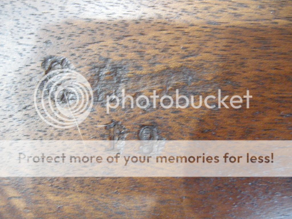

The markings on the stock appear to be C.H.G with 19 under them. Any thoughts as to what this would mean?
I am going to take the rifle apart to clean and oil. I have found info on how the bolt comes apart. I am unsure on how to remove the magazine, tried to search but unable to find info. Any tips on taking rifle apart?

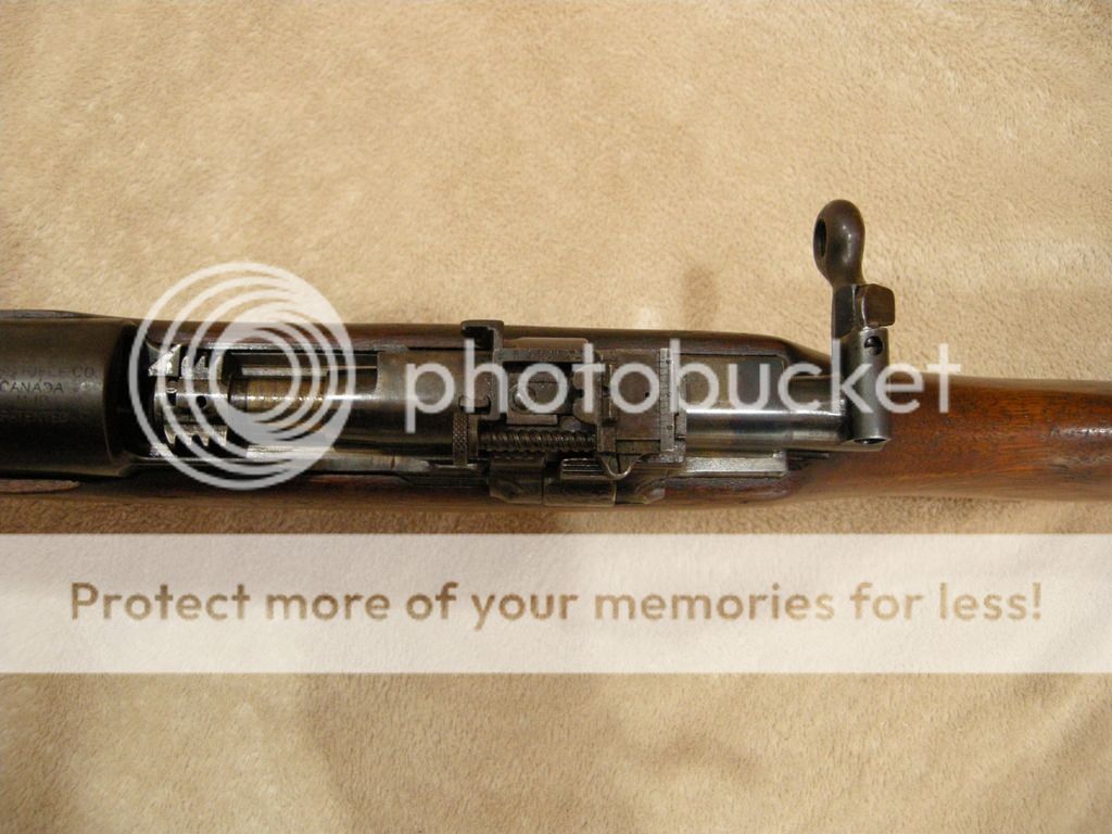

Very nice score! My brother picked one up a while back but his is marked "C.Y. number and then "H.G." so it's County of York, Home Guard. It's hard to tell from your pictures, but is the bolt pinned? If so, it may be an English home guard unit rifle. Lot's of good research on the Ross rifle forum, BTW.
G H G? What would the first G stand for? Any guesses? Guelph Home Guard? Galt?
Mine is HG over 100. No idea what that means.
A HG rifle is a fine example of what a 1914 produced Mk. III rifle was like. Small aperture, small bolt stop, etc.
It looks to be C.H.G. Hard to get the picture at right angle. Could b a G but looks different than the other G.

Bolt is not pinned.

Nice grab indeed. A very scarce rifle.

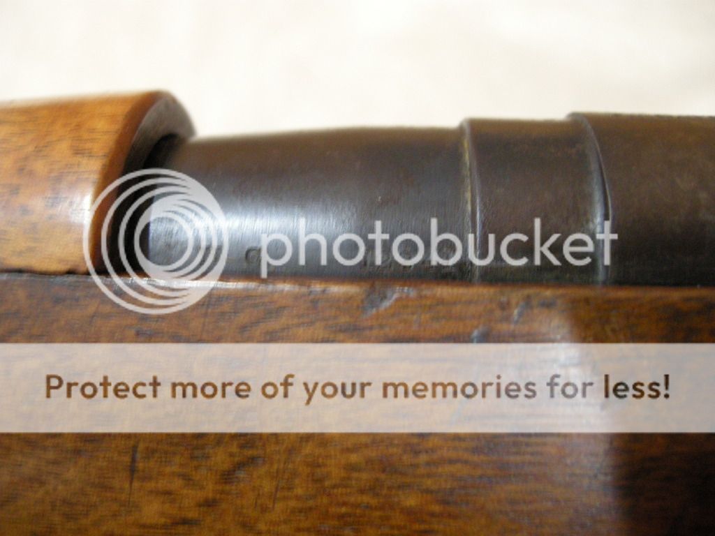

I had a good look at this rifle at Milarm last week. It is an excellent example of a Home Guard Ross MkIII. It appears to have all the early design features, such as Stamped Front Band, Early style (small) bolt stop, unpinned bolt shroud, and early small aperture rear sight. Possibly the mag housing is early as well. I didn't notice any markings on the barrel denoting enlarged chamber either. What is unusual about this rifle, is that it has Ross "target" style crown on the barrel, ie. flat. Normally they were rounded. Hopefully the bore will improve with cleaning.
Since your rifle has the small bolt stop, be gentle when cycling the bolt and don't allow it to slam hard against the bolt stop and cause damage to the bolt lug. Let us know how it shoots.

I was curious about the crown. Wasn't sure if it was normal or not. Tried to do a search bit couldn't find info.
The HG rifles were set up in the commercial shop which produced the sporting rifles. That may explain the crown.
HG rifles wouldn't likely show any of the upgrade features (bolt stop, large aperture, enlarged chamber, etc.) seen on service issue Mk.III rifles - because they weren't regular issue.
The pinned bolt modification was WW2. If I saw one on a HG, I would suspect a replaced bolt or commercial gunsmith modification.
I don't know if all of the sporters were flat crowned either, my M-10 and R-10 both have a rounded crown. Cost saving measure for a rifle less likely to see battle maybe?
