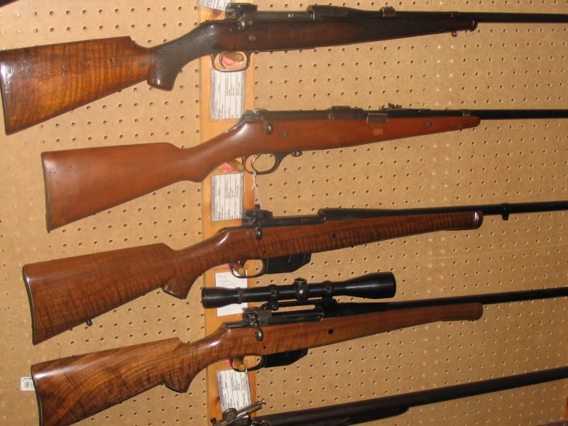

I have a Ross that was done up years ago and rebarreled into 6.5 303 improved by Epps in the late 50's It has a Redfield mount on it and only has one screw in the rear bridge.
It is the bottom gun in the picture
