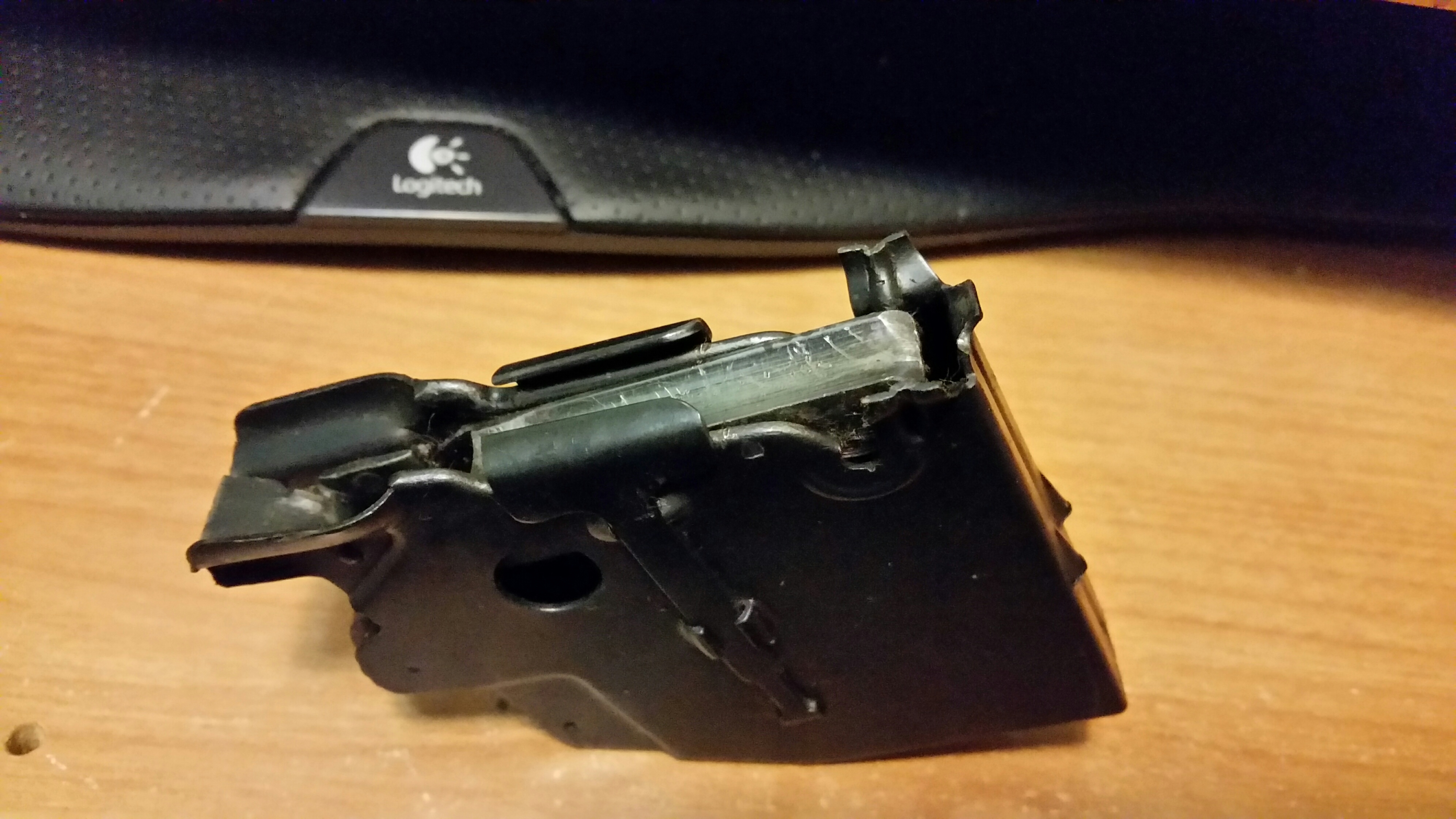

I recently picked up my first Ross, an M10 MkIII. It is an amazing rifle, but the magazine has some issues. It can't be loaded with stripper clips and if I hand load it, the rounds don't get pushed up high enough for the bolt to catch the rim. It looks like tab at the back is blocking the follower from coming all the way up. Does anyone have a picture of what a good mag should look like?
Here are some photos of my mag
any help or advice would be appreciated
Tiriaq is correct. The rear guide has been bent forward and should be bent back. A common problem. Also if the cartridges are not
feeding correctly the front guide similarly can be bent slightly up or down. On occasion I have also seen where either one or both side
guides have been filed down to try to allow better feeding. Unfortunately this 'cure' will only allow jams of fluted drill cartridges and
does little for feed. Most Ross Rifle drill cartridges were not fluted. On one occasion I had to remove the side guides and slightly bend them
out at the top for easier feed. Some of the earlier mags (yours is a later mag) were of lower gauge material so if
there was a shrewd blow to the mag which produced an inside dent the mag was rendered useless and often irrepairable. JOHN
All the above info is correct.
My first Ross was a mk3 and the tab on the rear of the mag was bent forward exactly like yours OP.
I bent it back with a pair of plyers and its functioned fine ever since.
thanks for the advice and the pictures. Its good to see what a functioning one looks like.

after using gentle heat and carefully using some pliers I was able to bend to tab into its proper position. I also had to bend the front tab down as the bolt would move the round 1/4 inch then slide over it not picking it up. It now pick up and chambers the first 4 rounds, but last round is still pushed about a 1/4 inch then the bolt just goes over top.

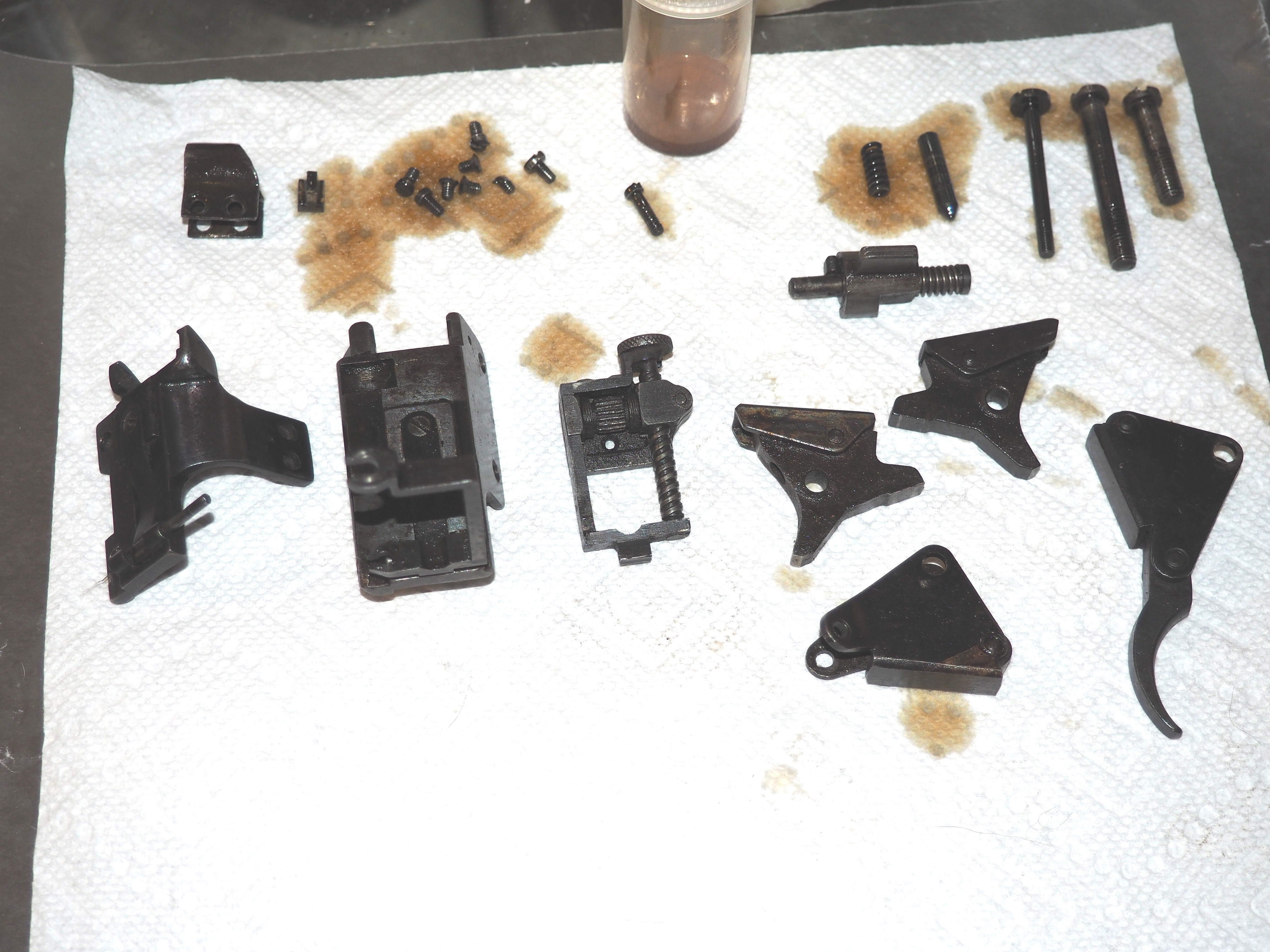

As for the light trigger, I borrowed a trigger gauge and it pulls between 1.5 and 2 lbs. looks like the sear has been rounded over. Anyone know if its possible to find a new sear?
The sear is next to a roller. sear sticks out at about 45 degrees pointing to roughly the top of the roller.

thanks diopter, ordered a sear and a cocking piece. I didn't think you could still find these parts.

I remember on of the sear was almost useless without some stoning. other was not immaculate.
