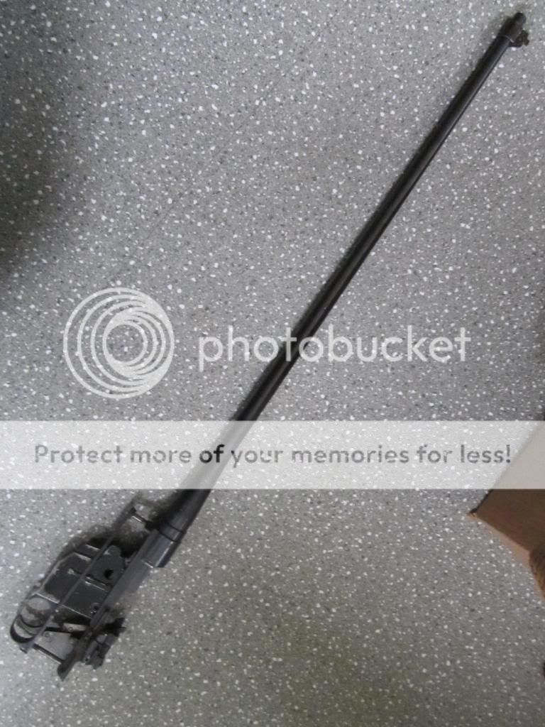

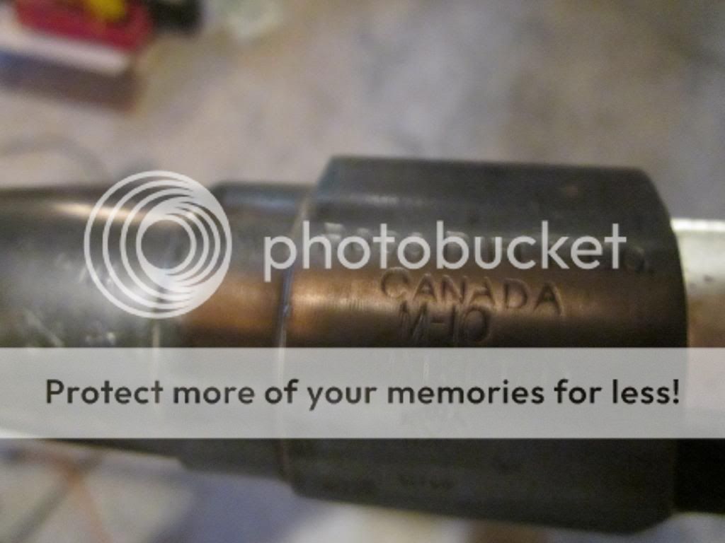

I bought an old Ross rifle without wood for 50$ back close to 20 years ago and it has been sitting in my gun cabinet since. I don't know much about it but there are not a lot of markings on outside of the top of the action and the side of the barrel. I would like to restore her to a reasonable shoot-able state. The bore and bluing look real good. In my quest I picked up a bayonet blade and a barrel band so far. Still a long way to go:)
It's a Ross Mk III military action. Barrel should be 30 1/2" long. Many were shortened. Many were shot out, worn out, dark bores.
If it has an original length, shiny, bright barrel, may be worth spending some $ on it. But looking for parts for them is not very rewarding.
Wood will be the hard part for sure, also it looks like the rear sight is missing also. But with patience you may be able to get her all back together.
I own a MkIII just like yours and it is an awesome shooter, and in my opinion yours would be well worth trying to restore!
Mark III (Model of 1910) it is.

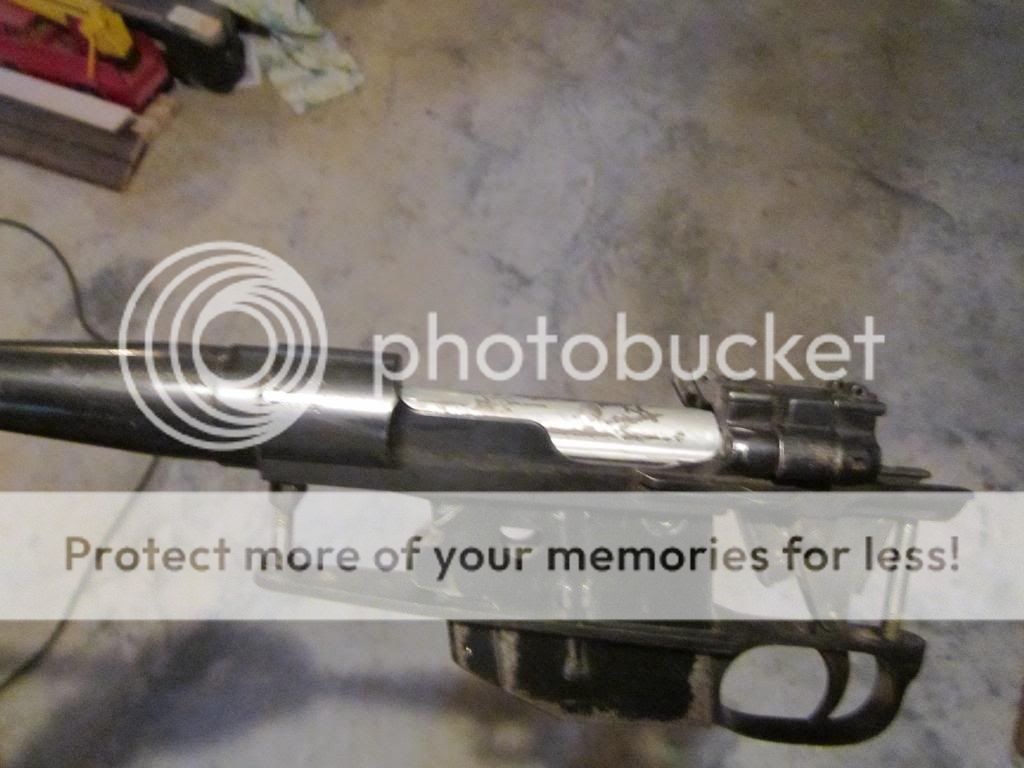

Can you provide some in-focus photos? We can tell a lot more from good shots.
Bolt LOOKS to have been Pinned, which is GOOD.
Rear sights are found at gun shows, $5 and UP. They need their Spring and Screw as well as the Pin.
ALL threads on the Ross are made to American standards: no strange threads from the Black Forest or anything.
Restore this one and you have a century-old rifle which will outshoot most modern ones.
Bubba'd stocks are out there; you can start with one and work from there.
Hardest part to find is the NOSE CAP.
Good luck!
I tried to get a few better pictures. The barrel is 30 1/4" from the muzzle to the action, good sign. The bore looks good far better than some 20 year old rifles I have seen. I'm leaning towards fixing her up. I did try to get a picture of the bore but that is beyond my skill.

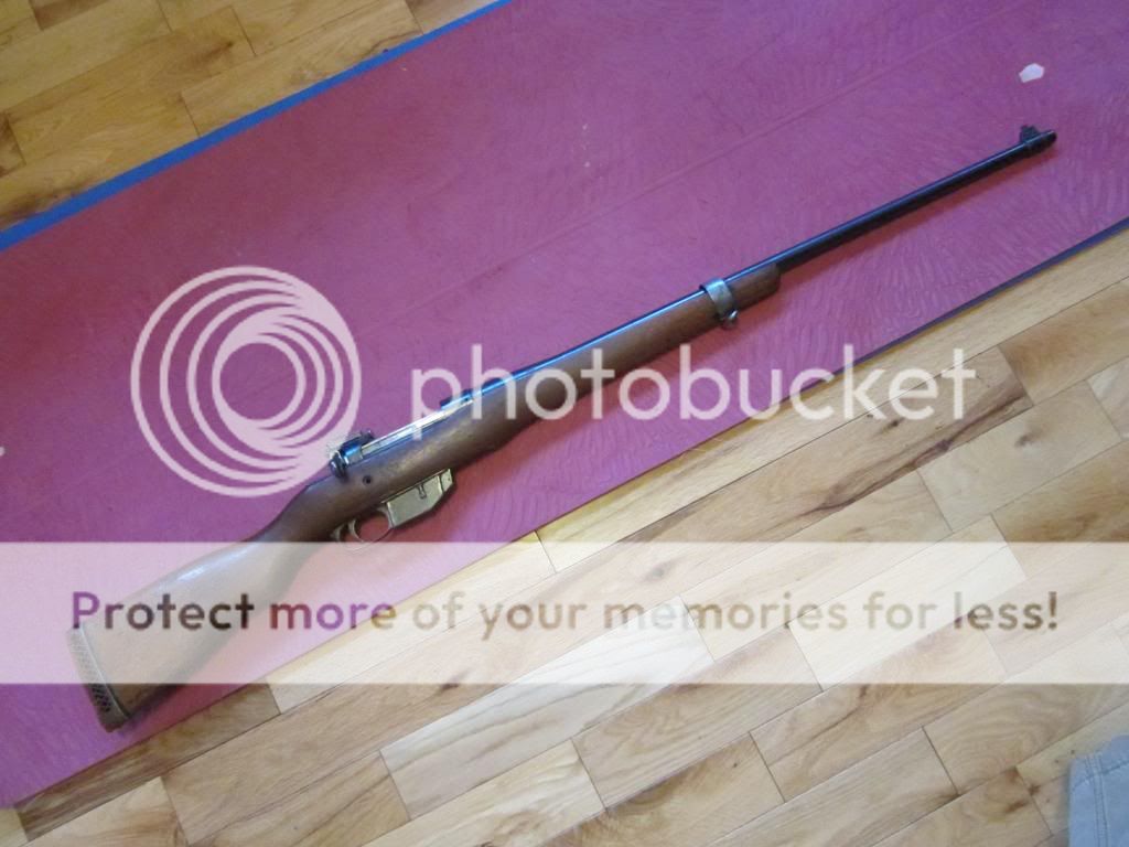

I just got some wood on the old girl (Thanks again Tiriaq for the stock.). My front band fits so I'm starting to get somewhere. I'm going to put an improvised cross bolt in the stock and see if I can get to the range this weekend. I'm not much of a target shooter so we will see if I can get minute of tin can out of her.
I made up a cross bolt and put a few rounds down range. It works like a top I had one time the feed was a little sticky but no big deal. I do have a question about the rear sight mine seams a little sloppy, is there any way to tighten it up or should I leave it along so I can blame it when I miss? i should specify the worm gear is loose at the top and bottom
The sight frame is the spring that tensions the shaft, so if the shaft is loose, take it out and carefully bend the top of the frame up a hair. Might be a good idea to measure before and after so you can see the change. When you refit the shaft, the top of the frame needs to be compressed downwards slightly. If the temper of the frame is good, it should spring OK. It's easier to do with the sight off the rifle, but then fitting the sight axis pin is a bit of a bugger too. A tiny C clamp or an machinist's Jorgensen clamp could be used under the sight bridge to compress the top of the frame if you don't want to take the sight out.
